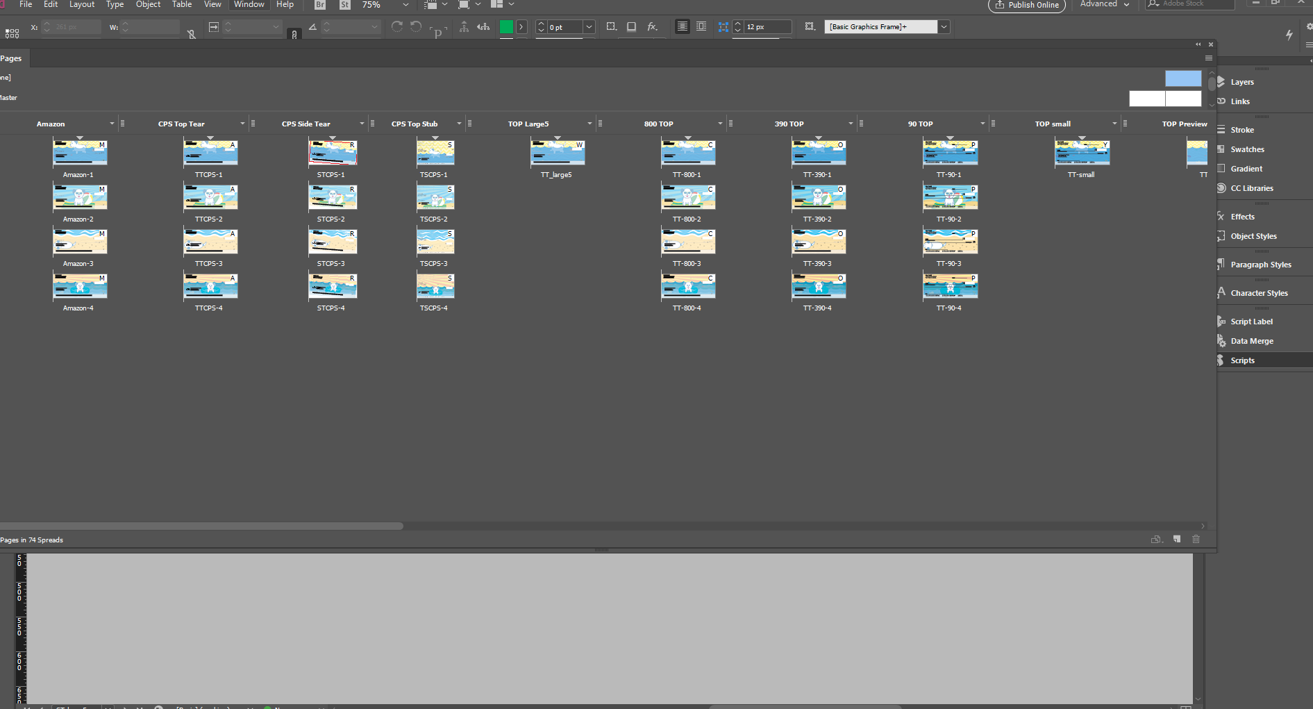

I work for a company that needs ALOT of web images of a product in various names and sizes because this is just the way the web developer created the site to pull images.
So what I did is create a template from InDesign where I can just drop in the main image and it's set up on alternative layouts for different sizes and naming. What I'd like to do is export every single page in the doc as a jpeg, but with the naming convention being what I named the individual pages.
I can't seem to do this. For example:
I have approximately 30 different alternate layouts in my pages section. I've named each page of a layout with what the individual jpegs should be named on export, but I can't just export them all with those specific names. Any way to do this? Please help! It would really help my job!

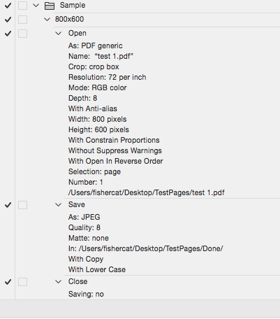

For automation I usually write scripts, so I don't use the Batch operations that much.
I could be sending down the wrong path, but when you are batch opening and saving as a different format you have to include the open and save as in the action you are batching and then check the Override Action check boxes, and include a serial number. Some thing like this where my recorded action opens a PDF to the desired resolution, Saves As a JPEG, and closes with no save:
Check Override Action "Open" and Override Action "Save As" Commands. Start the name with a Serial Number otherwise only one file will output
