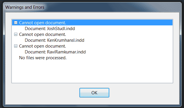

Anyway, my bigger problem is, unlike you apparently, I get error messages saying "cannot open document" for each doc, then "no files were processed"
I have no idea why it would say this!!? It doesn't matter what indd file I choose...I get the same thing? Any idea why?

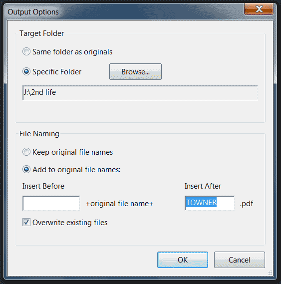

Here's what I have been trying.
File/Create PDF/Batch Create Multiple files.
Eventually, I get this window. (output options)
Then when I hit OK, I get this error message saying the files cannot be opened.

Macinbytes,
Thanks for the reply but as mentioned in previous post, it was simply that INDD CS4 which launched by Acrobat, was trying to open the INDD CS5 files I had selected. That was producing the error messages.
Now were just waiting to hear back from BobLevine's post in the Acrobat forum of why Acrobat is launching eariler versions on INDD.
