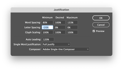

I had another play around and made this variation on the script. This time the function supplied tightens the tracking until either the maximum is exceeded, or a new word squeezes in to the line. Edit the maxTracking value to suit your preference.
Please bear in mind that if this is all you want to do with the script, it is much better to adjust this in the Justification settings of the paragraph style. Just put a negative minium letterspacing. Using the script, I think you will be hard-pressed to improve on the general composing capabilities of Indesign, but there's definitely room for a script to cater to special, specific typesetting needs. See what you think.
