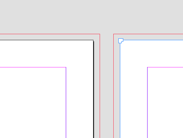

I'm designing my ID document with facing pages. Because it's going to be bound with Wire-O, I followed the good advice here and unchecked Facing Pages and moved the pages apart. The red boundary lines should show the bleed.
In most cases the system seems fine, but there are some pairs of pages that have uneven or overlapping red lines. Overlapping ones are shown in the screenshot. If they are overlapping, what should I do? Why are some uneven? Is this because ID thinks they are for a traditionally bound book and is making some kind of binding choice?

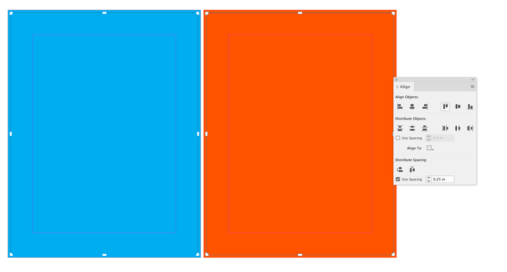

Also you can use the Align panel to align pages. Select the spread pages with the Pages tool:

Your screenshot shows that the bleed from both pages is overlapping because the pages are to close together. Select the Page Tool and then the right page. In the Control Panel click into the x-value and enter a higher value as you currently have. This should solve it.pages too close together (also different y-value cause staircase)

Thanks that did help, I pulled the right page down to match. But, I no longer see my bleed lines on any pages--don't know why--not sure if that's what caused it. I clicked away from Page Tool. ID is acting weird--like I used a layer mask, then merged a layer and it shows that image with a big weird white space! I quite out of ID then opened it again, still no bleed lines. Oh well, as long as my page-color squares cover the white I guess it's OK.

With Show Parent Page Overlay on, I'm now able to select both pages. When the Pages tool is on I can't use the Properties panel to align, so I can't get that "align to selected" option and the Align Bottom Edges, so that works.

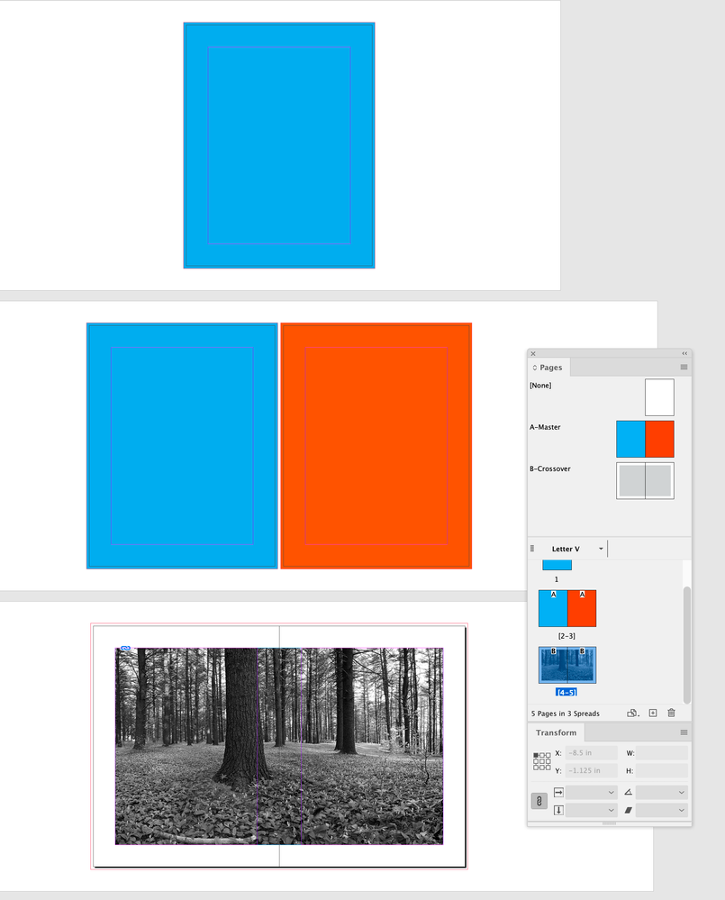

If you want to retain separate Parent Pages for left and right, and make use of the Align Toward (or away from) Spine, this method allows full bleed on a facing-pages setup.

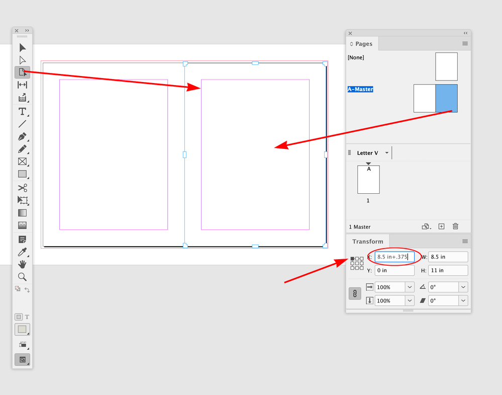

Hi @vixler , You can avoid misaligned spreads by setting up two page, parent page spreads
Then use the Transform panel to move the righthand page of the spread.
Here I have the right page selected with the Pages tool, and with the Transform panel’s anchor position set to upperleft, I’m adding 3/8" to the X value, which puts 1/8" space between my 1/8" bleeds:
Also, if your page items crossover the spread, you don’t need the split pages because the bleed will be picked up from the opposite page, which is what you want in that case. So here I’ve made a crossover parent with no gap:

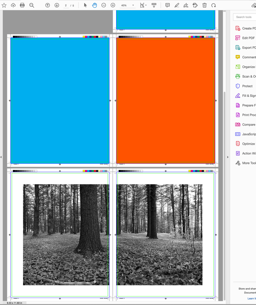

An Export to PDF/X-4 with printer marks and document bleeds:
