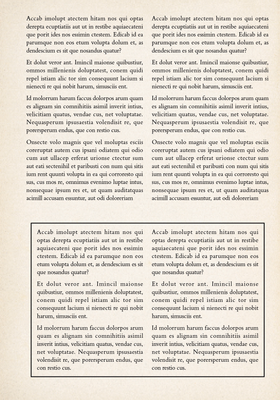

Hi
I'm trying to create something like the below, where the text in the box should remain in columns but the border should encompass the whole section.
Using a border within the paragraph style puts a box around each column, so two separate boxes rather than a single box around the whole section of text with the style applied:
Rules only do the top and bottom, not the sides, but that does span columns. Shading isn't what I need.
Would love to be able to do this without anchoring a box that has to be resized every time.
Thanks!

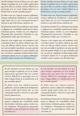

yes except there is a break so the paragraphs line up as I had in my screenshot. It obviously wouldn't work if the start of the section was at the bottom on the left and the end was at the top on the right. For example, the blue is 1 paragraph style, then the green is another one which spans columns and has no text to create the break, then the pink is a 3rd paragraph style that I need to border around.
But it's a moot point now anyway because the client just asked for a distressed border which you can't do in InDesign so these sections will have to be taken out of the primary text frame and anchored back in anyways. Thanks for your help though!
