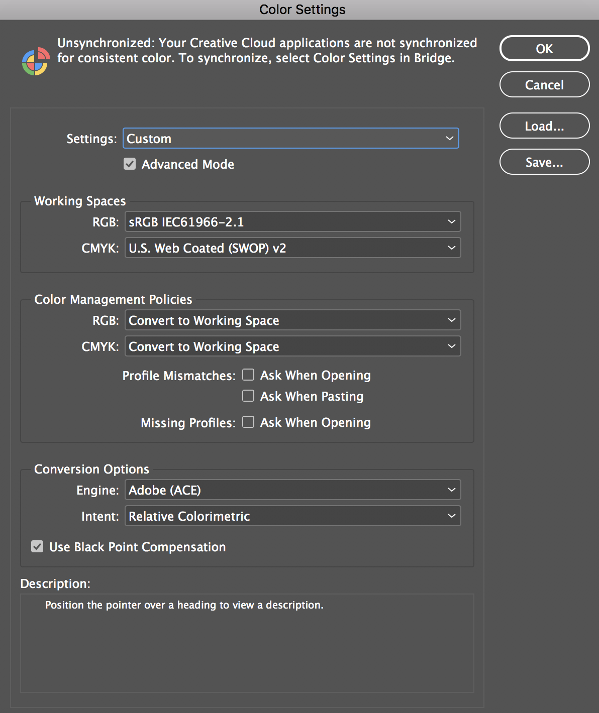

My Color Setting are:

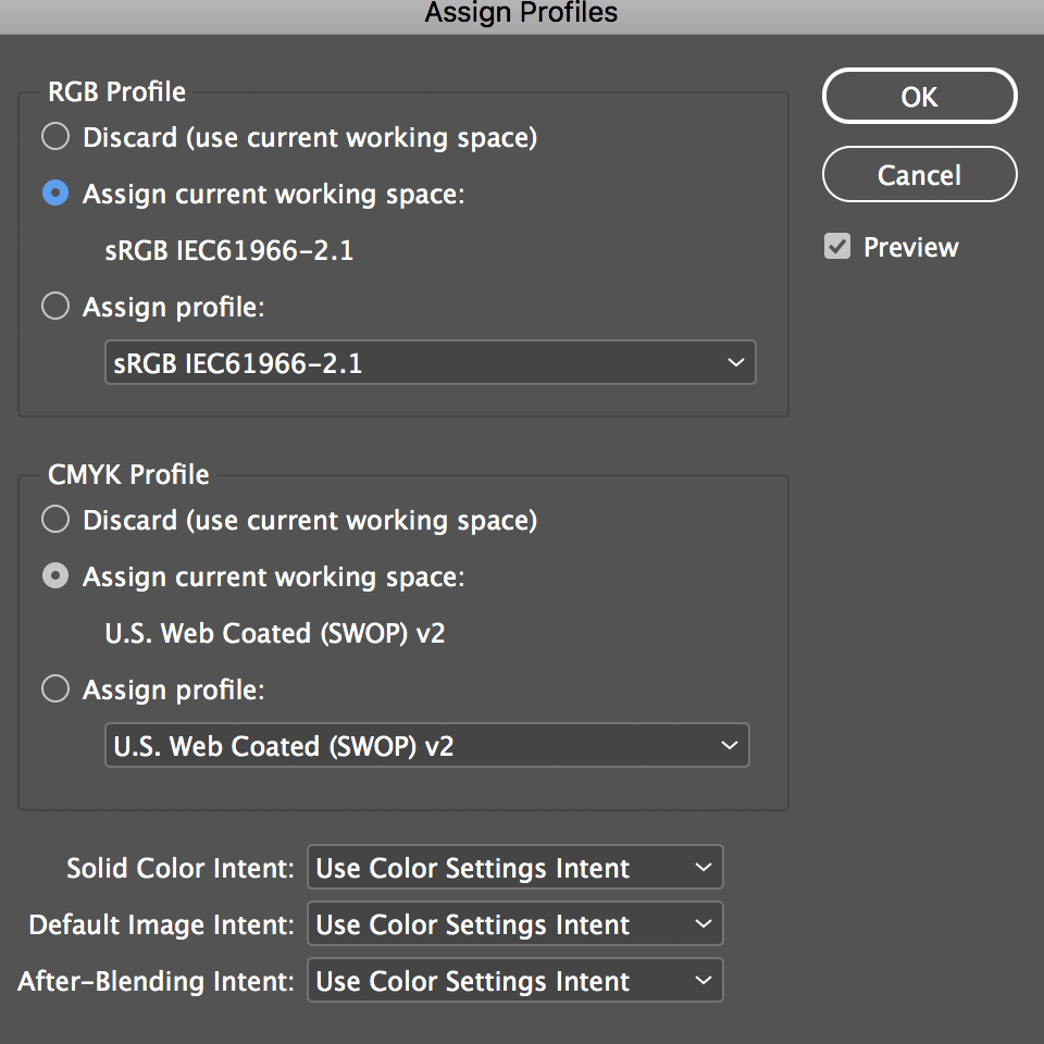

My Assign Profile settings are:

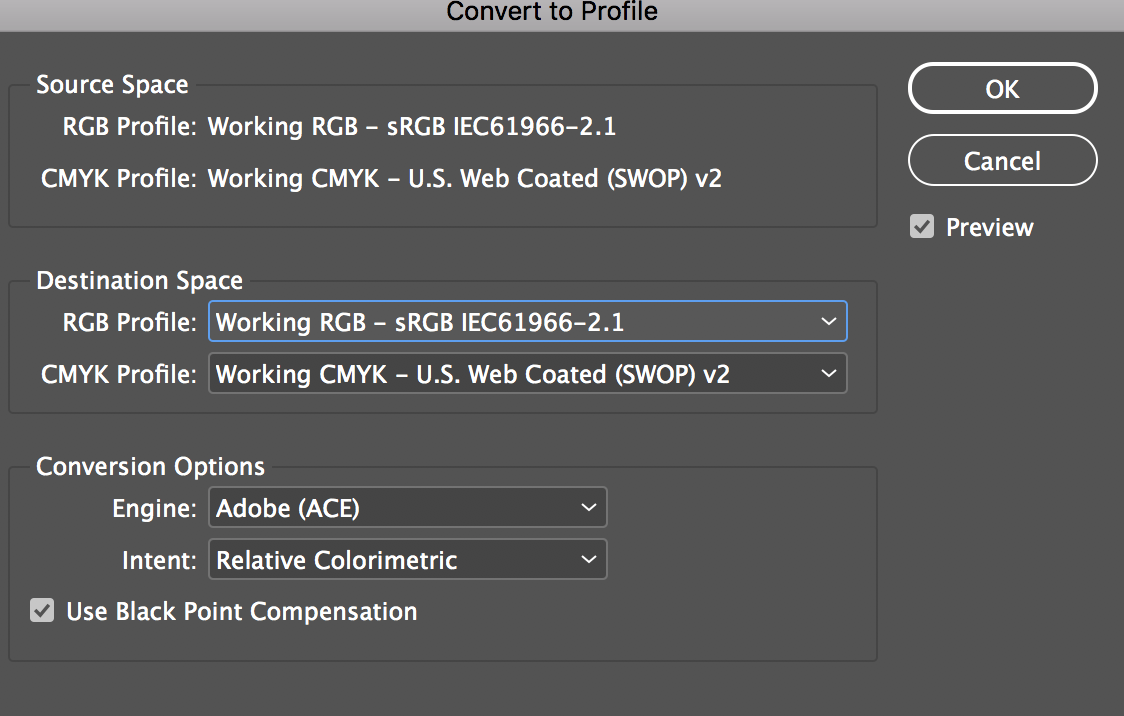

My Convert To Profile setting are:

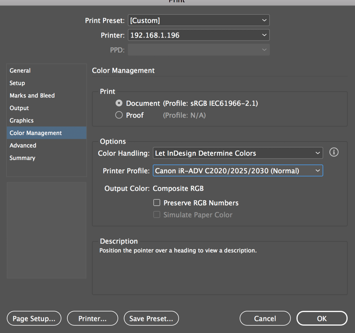

When I try to print a Booklet, I am not sure in which option on the dialog box "print booklet" of I should put the printer canon c2020i Profile, and the pictures are all suer saturated and reddish.

The question is if to put the printer profile on this stage or should I set the document profile with the printer profile?:
or is better to leave sRGB everywhere.
the color management of the printer is set on ColorSync: sRGB
my hard question is: what override what.
you start from the document, then you work with the Proof Setup of the printer, then when you print you have 3/4 different point to set with a color profile.
Why are you making the conversion to US SWOP? Will the catalog be printed on a US Web press? InDesign and Photoshop use the same Color Managment, so in most cases making CMYK conversions in PS is a waste of time. If the job is headed to an offset press you can make the final conversion to CMYK via PDF export. In that case you are not committing to a CMYK destination space in advance that may or may not be correct.
