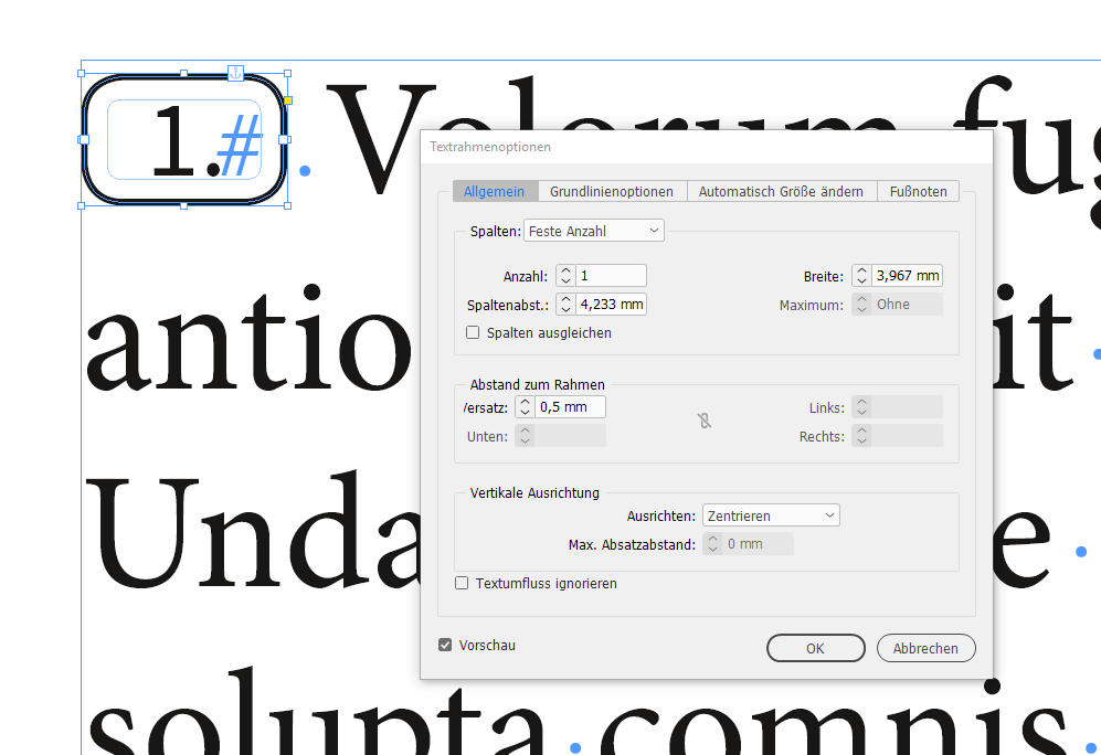

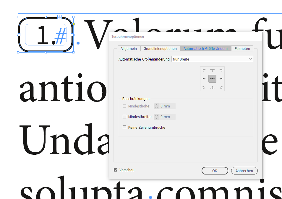

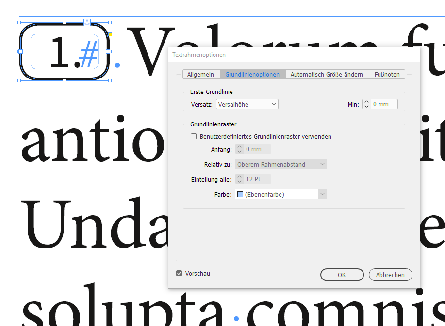

So I would suggest not an anchored rectangle, but an anchored text frame holding the auto number plus a second character to trigger the numbering where the width of the frame is done automatically using a text frame option ( InDesign CS6 and above ).
From my German InDesign CC 2019 showing the text frame options:
Baseline settings of the first line in the frame using Cap Height:
Automatic width only:
