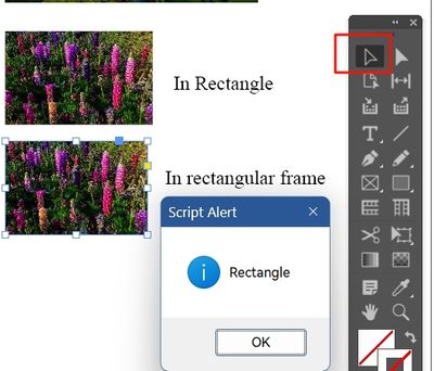

Hi rob day.
Choosing these two images using the selection tool is invalid.
The meaning is that no matter how s changes,
The image and imagePath must be consistent.
var s=
var image=
var magePath=

Guide ,
Aug 14, 2025 Aug 14, 2025
quote
looks like there is some kind of corruption with your bottom 2 images?
By @rob day
There is no problem with those two pictures.
You can find two pictures and paste them inside the framework, and the test results will be the same.

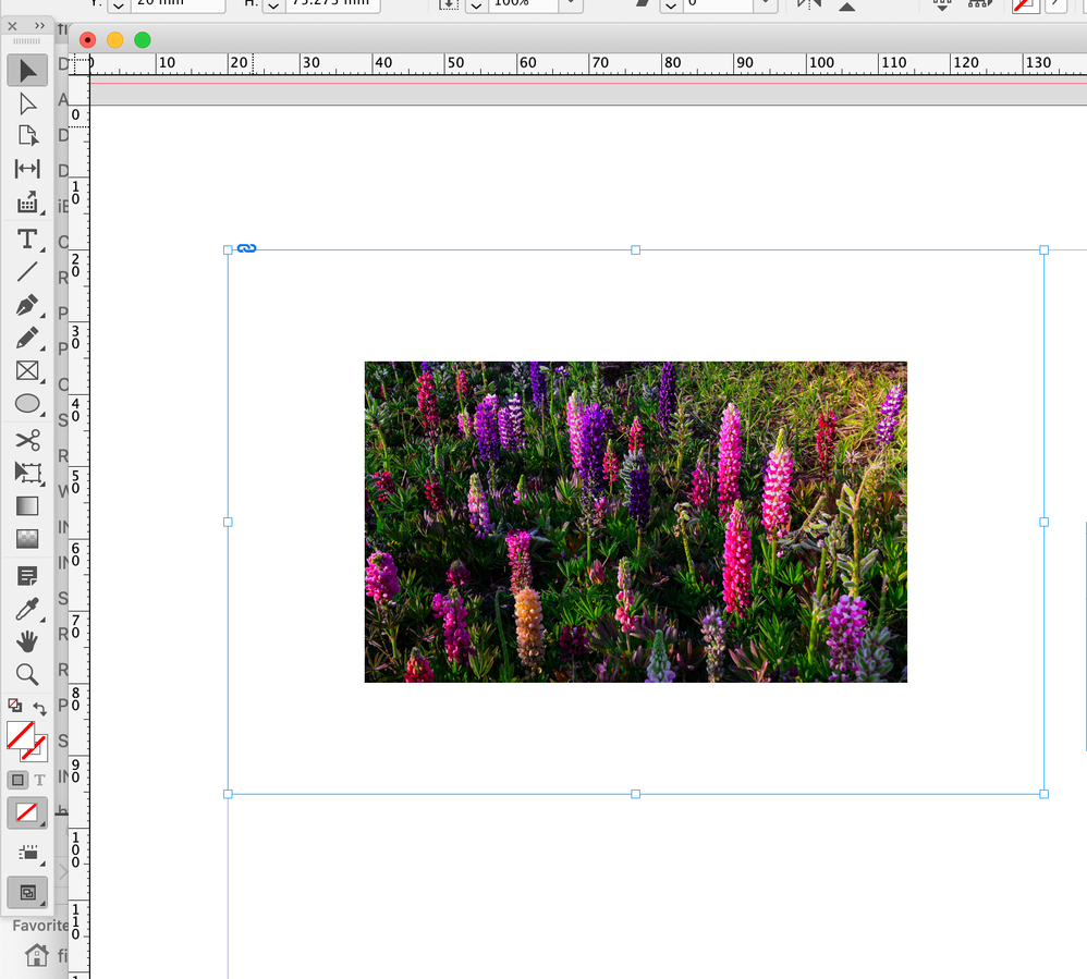

You have an image inside of a frame inside of another frame—a good example of why selections can return unexpected results:

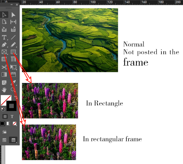

Guide ,
That's because I was in the same box before.
Replaced with another image.
I frequently paste images into the same box, and the old box is retained.
I couldn't find a better way to operate, so I had to manually delete the extra frames.
Use Paste Into.
This is why scripting selections is so diffucult—you can’t assume what is selected.

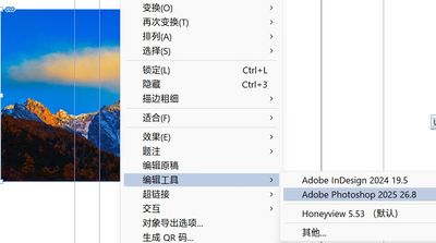

Hi @rob day  @m1b
With a slight change, I am stuck again.
How can I modify it so that I can open the image pasted inside the frame?
Whether using the selection tool or the direct selection tool.
Thank you very much.

In this thread, we discovered that when opening images in Photoshop for editing via script, the images in the ID do not automatically update.
However, when opening images using the method shown below, they will update automatically.
Can the “menu operation” you mentioned in another post accomplish these steps?
When I select an image (the link window does not need to be displayed), it should open in the manner shown in the image below.
But there's one issue: the Photoshop version might be uncertain.
