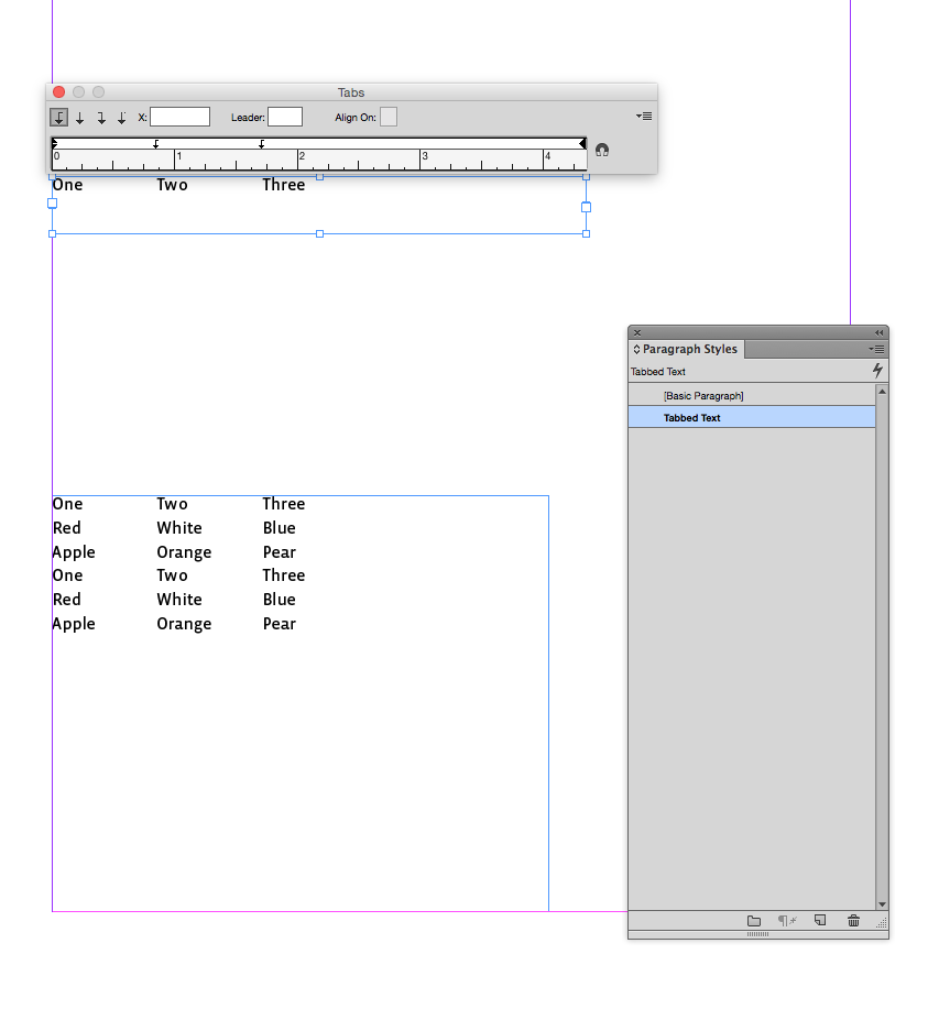

Yes, but it's pretty quick—just select the text and drag the tab arrow as in my screen shots. And if you are using ¶ styles, you can refine the style after the adjustment, as per Rob's answer.

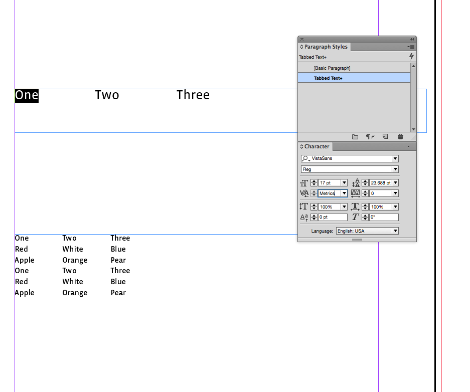

You could then scale a frame with one tabbed line, and then redefine the style. Some thing like this where I have a Paragraph Style named Tabbed text:
I scale the temporary text frame, which causes a style override +
Redefine Style updates the document's styled text and I can delete the temp frame:

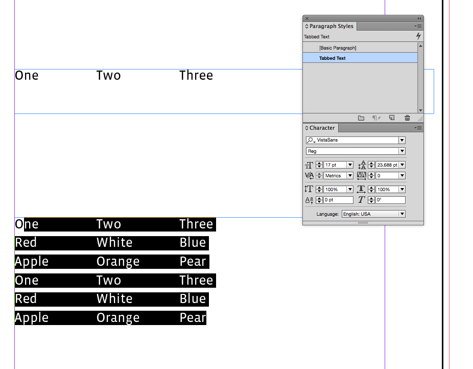

Mar 05, 2017 Mar 05, 2017
Couldn't you just select a character after the scale and set the font size to the nearest whole number, then Redefine?
16.92 to 17pt

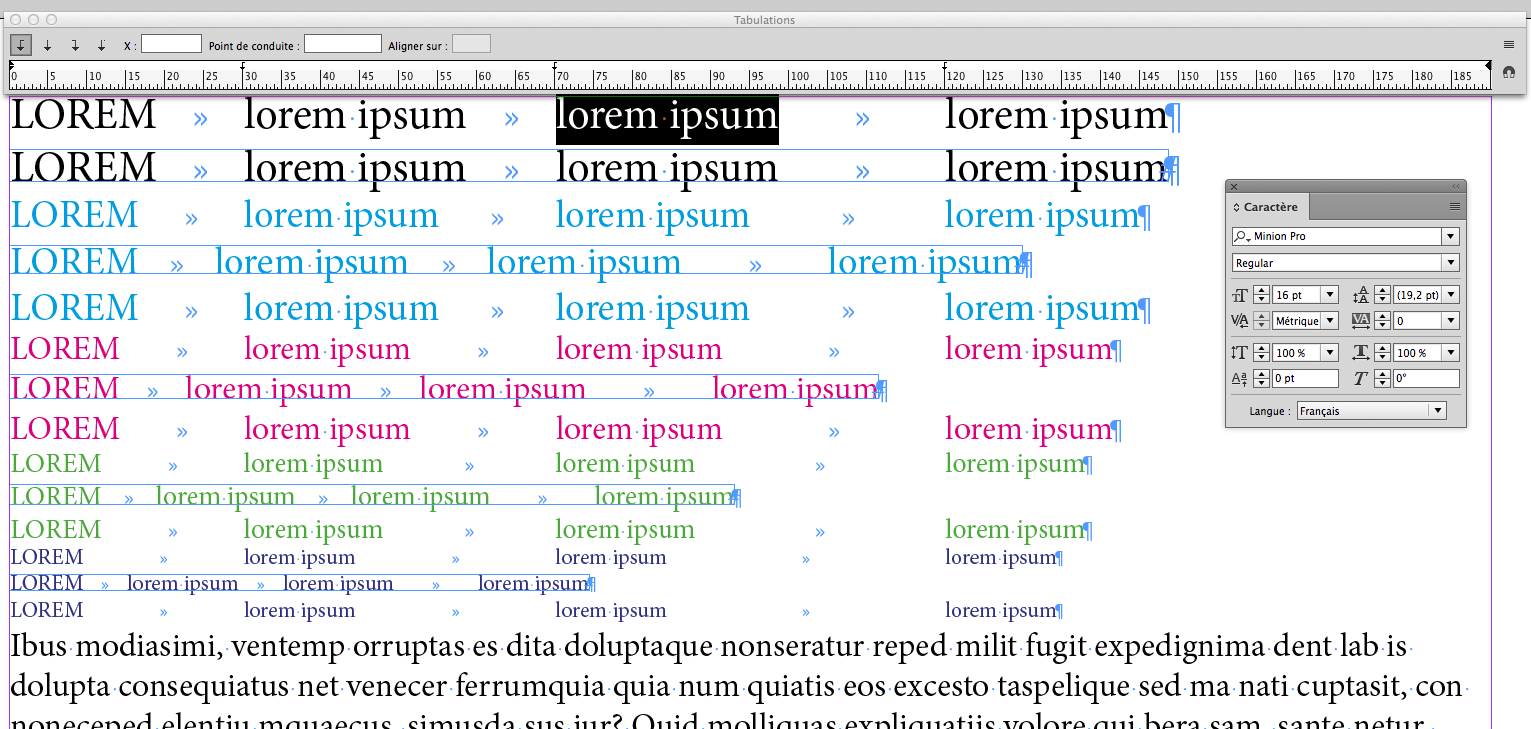

If you really wanna change the Tabs position when you change the font size, as:
At the beginning, the "black" font size = 16 pts.
In "blue": 14 pts.
In "red": 12 pts.
In "green": 10 pts.
In "dark-blue": 8 pts.
Note: the texts in the anchored text blocks have been reduced by the reduction of their respective block!
That's the result we would like!    [3rd line in each case]
To do it, just select the text and play the code below!
The only thing to do is to indicate the new font size!
    0116_NewTabsPositionAfterTextFontSizeChange_MichelAllio.jsx
    Script written by Michel Allio [2017/03/06]
    See: https://forums.adobe.com/thread/2285966
    Object: Reposition Tabs after having modifoed the text selection font size! …

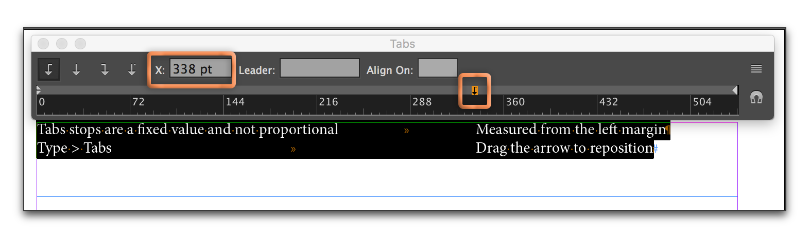

Tabs use an absolute value, measured from the left margin of the frame. If you re-size the type and the original values no longer work, select the text, and choose Type > Tabs. Drag the tab arrow or change the X value. They will not change themselves.
