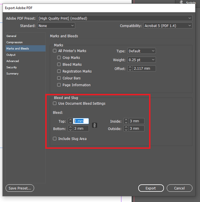

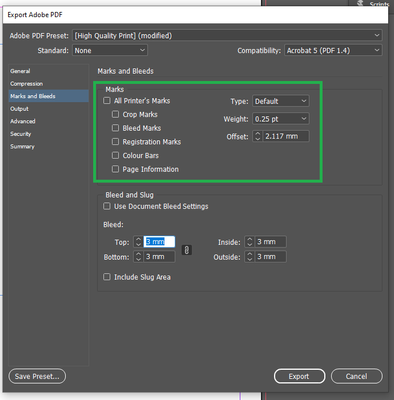

LEGEND ,
Nov 23, 2023 Nov 23, 2023
Document settings:
PDF Export settings:
Or you can override it and type values manually when exporting:
Remember to UNTICK EVERYTHING in the green area - in case your printer DO NOT WANT those extra lines

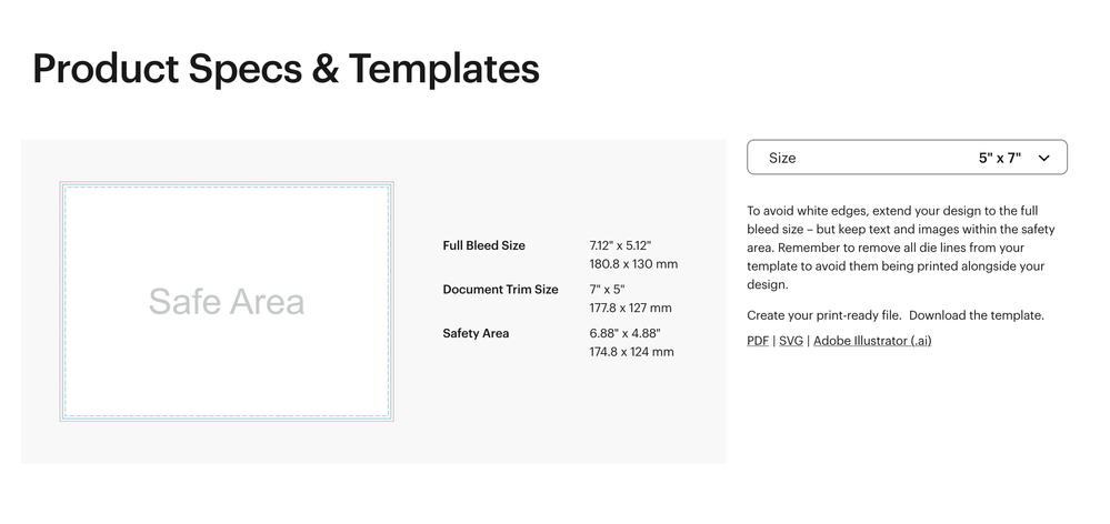

Hi @Katherine25238449muqx , Vista does not want crop marks. They have templates and trim & bleed specs for all of their card sizes--you might want to download the template for the card size you are printing
