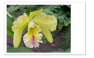

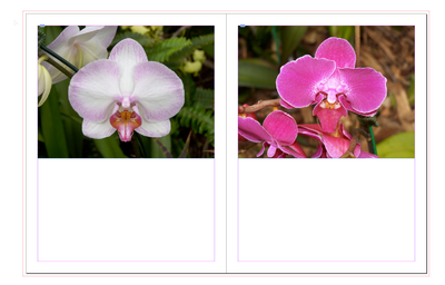

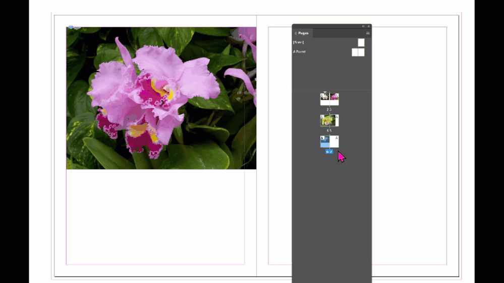

After re-reading your question, I believe it is about the inside/gutter bleed.
If you don't have anything that touches the inside page edge on either page, don't worry about it.
If you have a large image that crosses over both pages, don't worry about it.
If you have an image on either page that touches the inside page edge, you need to process it:
Then adjust your bleed for the graphic(s) touching the inside gutter.
