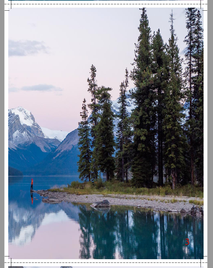

Here's my master spread with an image pulled out to the bleed guides:

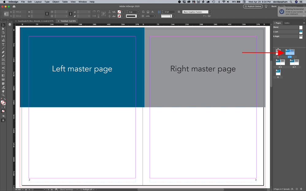

Here's the pages 2-3 document spread:

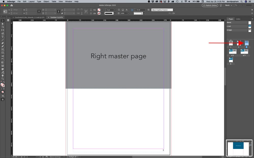

Here are pages 2 & 3 after I uncheck Allow Selected Spreads to Shuffle and pull page 3 to the right:
Notice that the image is still in place on each page. Here are pages 2 & 3 in the PDF, exported as pages (not spreads) with bleed on the inside:
Screen Shot 2020-04-29 at 7.26.53 PM.pngScreen Shot 2020-04-29 at 7.27.03 PM.png
I think this is what you want. Are you getting something different?
