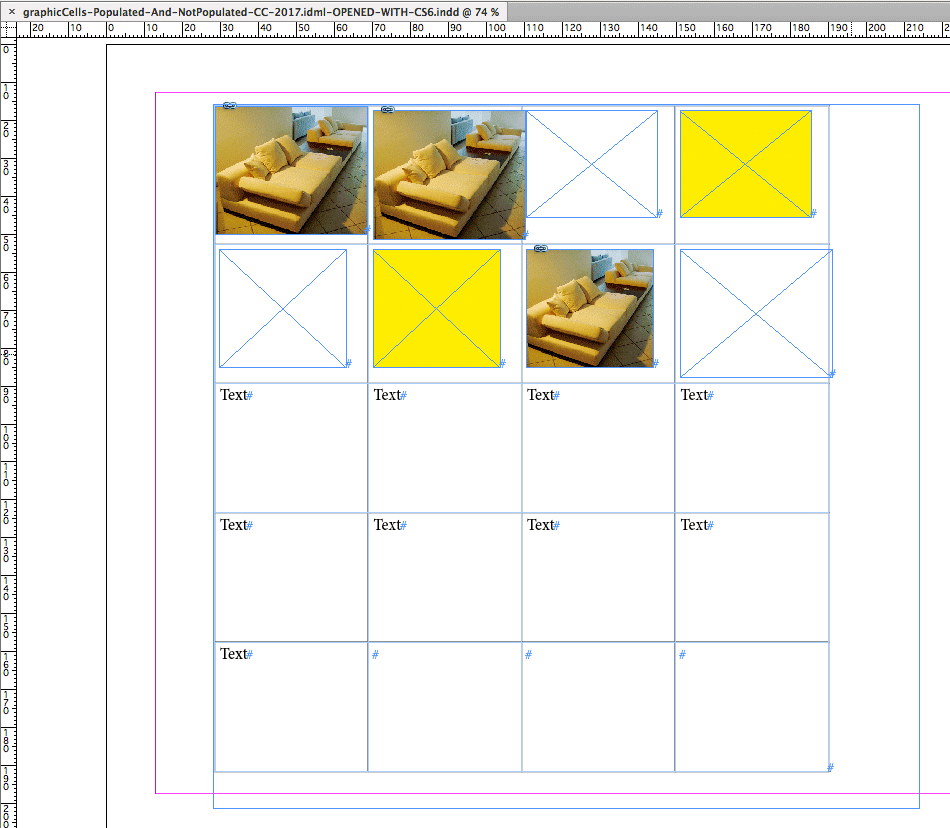

Mar 06, 2017 Mar 06, 2017
But back to your problem with crashing.
Yes, there is a problem with "downgrading tables" from CC 2015 / CC 2017 to CS6 or CC 9.3.0 or even CC 2014.
There is a new table feature named Graphic Cell.
If you are using this feature extensively you'll see that all your graphic cells are converted to text cells and the images with graphic cells are transformed to anchored objects.
Before, table built with CC 2017 using graphic cells:
After opening with CS6 using IDML exchange:
Note the different insets in the cells.
Example: In CC 2017 you cannot see any differences with cell 1 and cell 2. But internally there are differences in inset values.
Before the cells were converted from text cells (default) to graphic cells, cell 1 and cell 2 had different inset values.
These values do show up again after opening the IDML with InDesign CS6 where the import mechanisms tries its best to read out valid infomation. All that's not known to CS6—graphic cell attributes—is ignored.
Uwe
