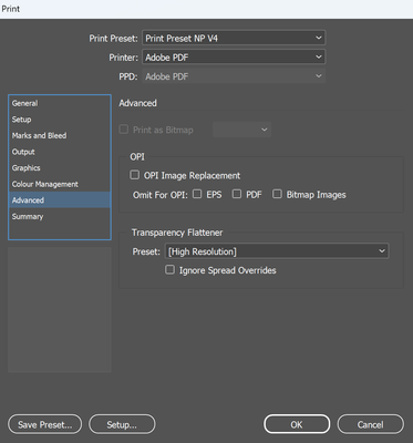

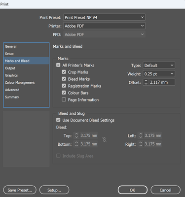

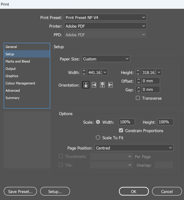

Could you provide detail about how you go about printing to PDF? What are your settings? And why not export to PDF to get a better-working PDF?
Mike Witherell
Votes

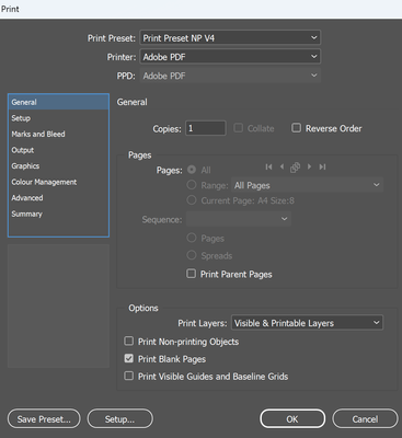

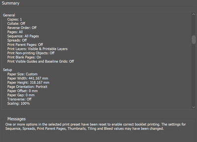

Community Beginner ,
Feb 23, 2024 Feb 23, 2024
Copy link to clipboard
Copied
    I did do the ctrl+E and then to acrobat but like I said it wasn't really conclusive since I want trim marks and bleeds so the edges looks nice and with no white line , so I just want to know if there's a way to make this work from ID directly

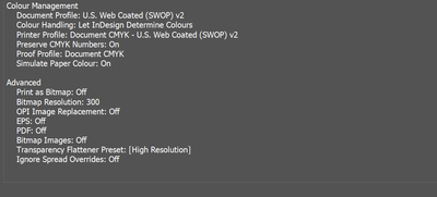

Copied
oh and this too , maybe it'll help
Votes

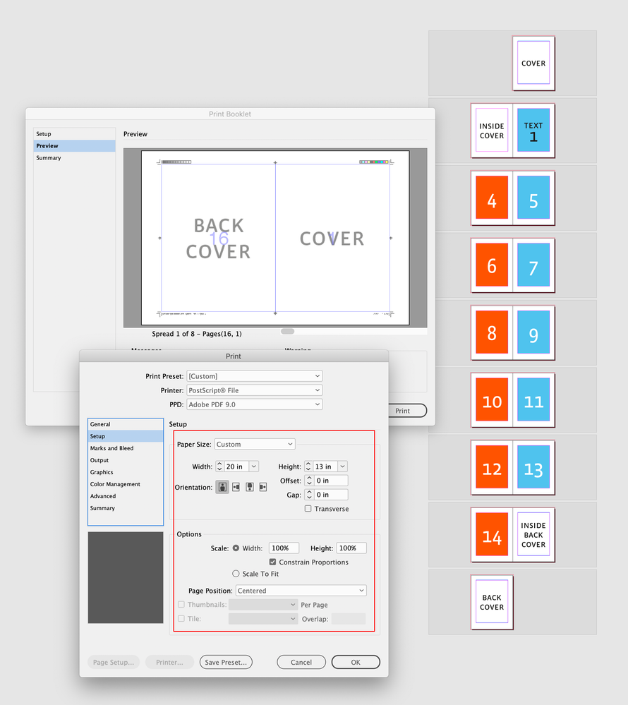

Hi @oko8, You need the Adobe PDF 9.0 PPD with Postscript file set as the Printer. See this thread:
https://community.adobe.com/t5/indesign-discussions/indesign-print-booklet-only-half-pages-exporting...
Votes
Copied
ok do you have a link to where I can download that and if anything , more details about the process of doing that
Votes
Copied
This OP appears to be on Windows, and the Adobe PDF 9.0 PPD appears to be already in play, according to the OPs second set of screenshots?
Mike Witherell
Votes
Copied
oh so the "Adobe PDF 9.0 PPD with Postscript file set as the Printer" is not the correct answer then ? , I think it has something to do with postscript, I'm trying to figure out what though
Votes

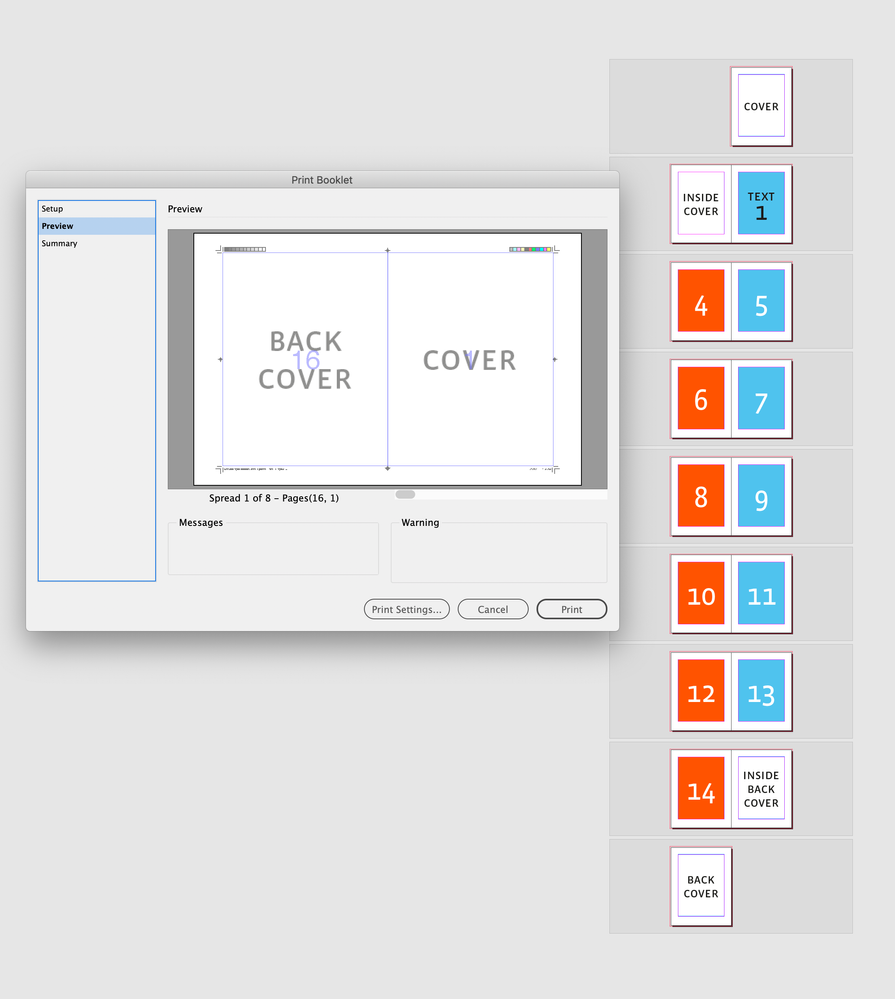

Copied
The PPD is cross platform, I think you need it for the custom Setup required for the imposition
