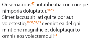

In my document all superscript footnote numbers at the end of a sentence have the period follow the footnote number instead of preceding it.
The footnote numbers all have a character style.
How can I change the position of the period to BEFORE the superscript numbers?
THANKS!

Hi Winterm!
Thank you so much for trying to help.
Unfortunately they aren't 'Footnote Reference Markers' but just orange superior numbers...
So your trics didn't work and I still haven't found a solution...
Help!

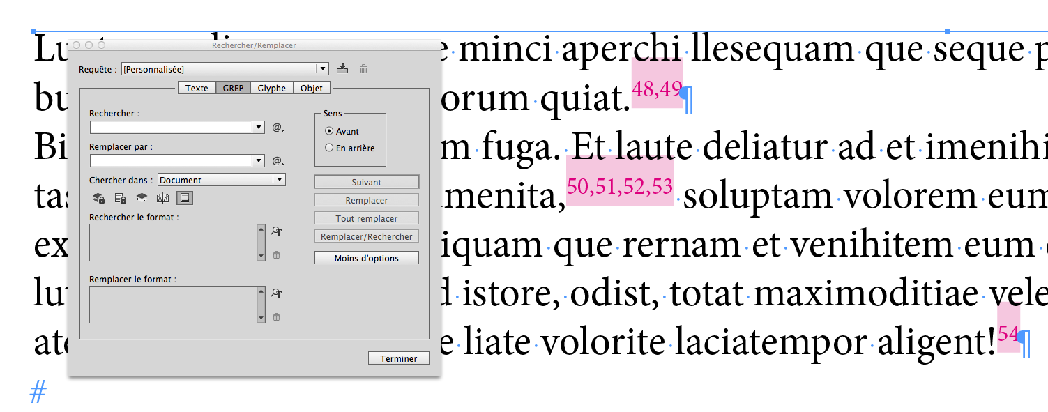

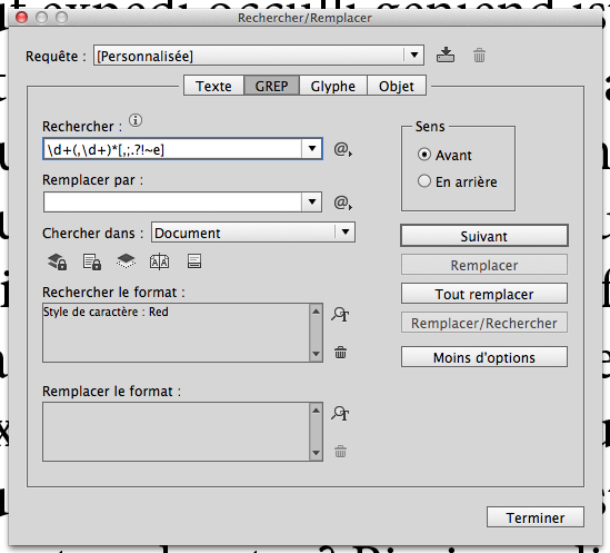

Surely not with a simple Grep code!
~F(,~F)*[,;.?!…] if you play with "true" footnote calls!
\d+(,\d+)*[,;.?!…] if you play with "false" note calls!
In the first case, don't try! … To play it, you'll need a script!
In the second one, euh! … Well! you'll need the same script! [more simple to explain! ]
Of course, in the 2 cases, just enter the first or second Grep code into the first form ["Find:"] of the Find/Replace InDesign window …
… and just 1 click for launching the script!
Done!
