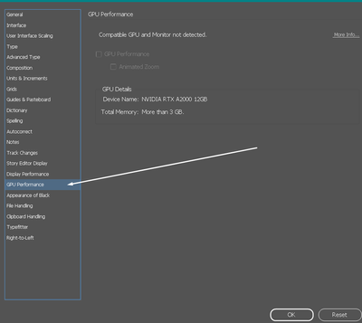

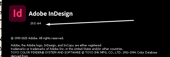

Contributor ,
Sep 09, 2025 Sep 09, 2025
Version :
>>Preferences > Performance
There is no such setting. Maybe you meant: "GPU performance"
Is this done correctly?

Adobe Employee ,
Hi @SuzzyFlamingo,
Thanks for confirming the version and sharing the screenshots. The setting I was referring to is GPU Performance under Preferences > Performance, and from your screenshot it looks like you've found it correctly. I also noticed the message saying "Compatible GPU and monitor not detected", which usually appears when the monitor resolution is below 2K. You can check the InDesign system GPU requirements here for more details.
Could you let me know if the slowdown happens in all documents or only in certain ones? It would also be helpful if you could test the behavior in Windows Safe Mode, so we can better isolate the cause.
