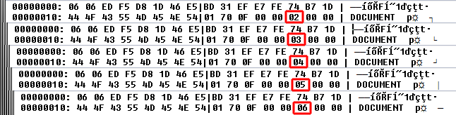

Then he need to check 30th byte of INDD file.
2 - ID 2.0.2
3 - CS1
4 - CS2
5 - CS3
6 - CS4
robin

LEGEND ,
Feb 25, 2010 Feb 25, 2010
Kris,
I just checked both Mac and Windows files, and did not see a difference.
The first 30 bytes in every file I checked were:
06 06 ED F5 D8 1D 46 E5 BD 31 EF E7 FE 74 B7 1D
44 4F 43 55 4D 45 4E 54 01 70 0F 00 00 06
(or 05, 04, or whatever)
Harbs

Oops - correction - that needs to be a PowerPC Mac. Intel Macs have the same endianness as PCs, so they look the same. Try to get hold of a file created on a PowerPC Mac (which has Motorola endianness) - it's different, you'll see.
Cheers,
Kris
LEGEND ,
Feb 26, 2010 Feb 26, 2010
Ah. That makes much more sense!
Here's the first 36 bytes of a PowerPC file...
44 4F 43 55 4D 45 4E 54 02 00 00 0F 70 00 00 00
06 00 00 00
Harbs

Participant ,
Essentially, from position 25 onwards you see two 4-byte longs - 0x00000F70 0x00000006 (or whatever the version is). On Intel-endian machines they are encoded as 70 0F 00 00 - 06 00 00 00, on PowerPC-endian machines they are encoded as 00 00 0F 70 - 00 00 00 06. Unless you're aware of the endianness, the version number will seem to 'shift' position in the file depending on the file's origin.
To do it correctly, you need to read the single byte at position 24. If that byte is a 1, the file is Intel-endian. If that byte is a 2, the file is PowerPC-endian.
Then you need to read 4 bytes from position 29 onwards. Those 4 bytes need to be interpreted depending on the endianness. The resulting 4-byte long is the version number.
Also works for other files (e.g. indb etc...).
