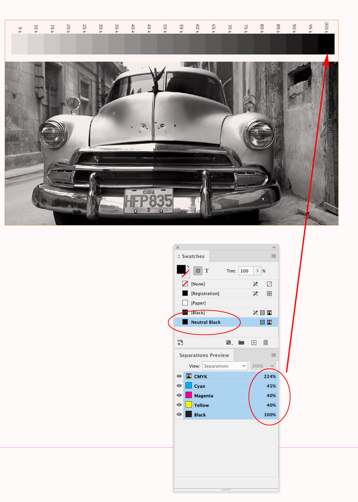

The other, safer, and easier way to do it is by placing flattened Grayscale images. Flat Grayscale images can be assigned a color or Swatch which can be anything. Here I’ve placed a Grayscale image, selected the image and set its color to CMYK 45|40|40|100:

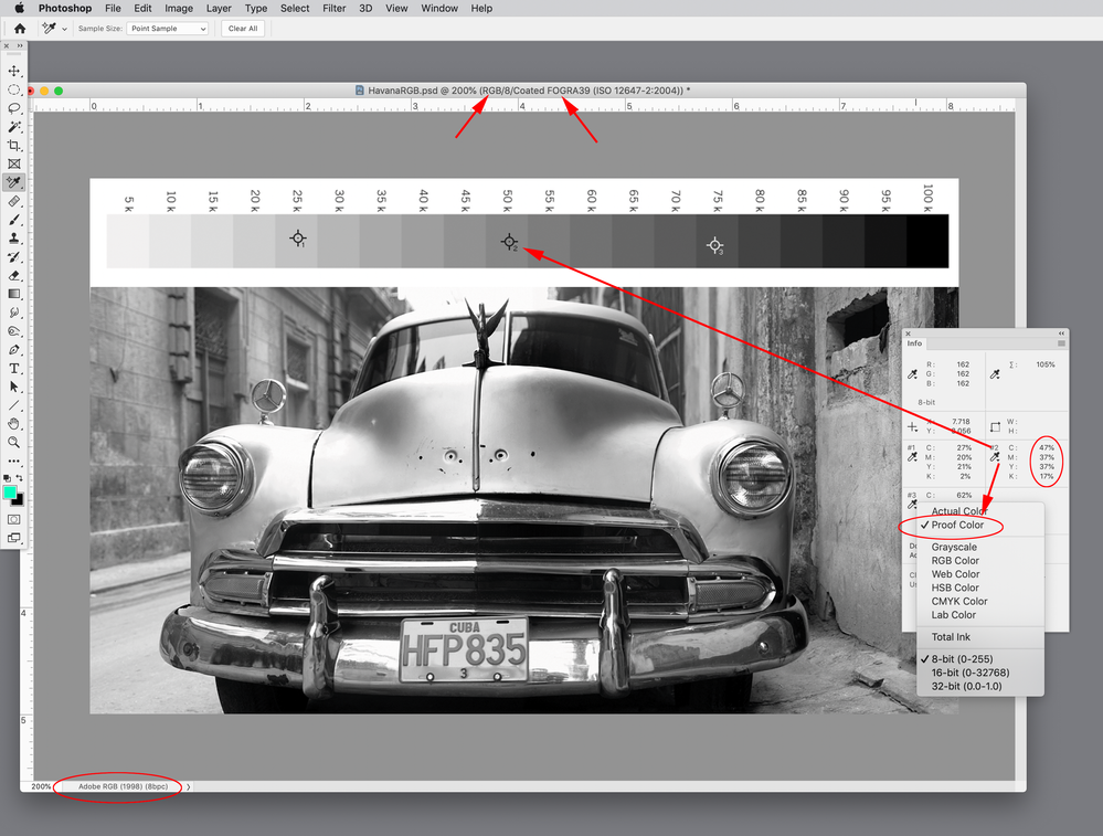

Also, in case you are not aware, you can get the expected CMYK conversion for profiled RGB colors without actually committing to the conversion. Here I have Proof Colors turned on with my Proof Setup set to Coated FOGRA39. With my Info panel’s eyedroppers set to Proof Color I can get the expected CMYK values for a conversion to FOGRA39 without committing to the conversion:
