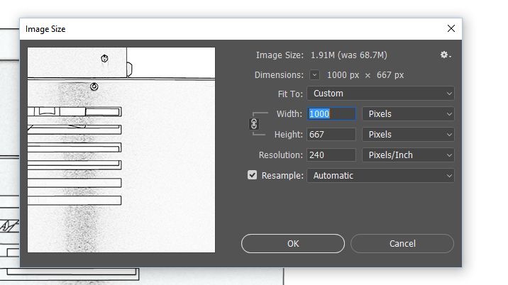

Orientador ,
Jan 10, 2017 Jan 10, 2017
Edit the resolution of the image in its respective programme (either photoshop or illustrator) and resize the image resolution to min 150 or best 300 PPI.
Also proportionally increase the width to min 500 pixels or max 1000 to look good on most finished product results.
Upsampling in Photoshop cannot create information that was not there to begin with; this won't help the blurriness or quality of the image.
Traduzir
Denunciar
Diretrizes da comunidade
Seja respeitoso, dê crédito à fonte original do conteúdo e verifique se há cópias antes da publicação. Saiba mais
Orientador ,
True. But it will at least enhance a bad picture to possibly the level required.  If the image looks still too bad then simply another image must be used or the supplier of the image should be contacted to see if it is possible to obtain a better quality version of the image.

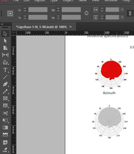

Novato ,
MAIS RECENTE
I tried large image and small one I also enhanced the resolution
the original the gray one and then what i did export the original and edited in photoshop then placed it
