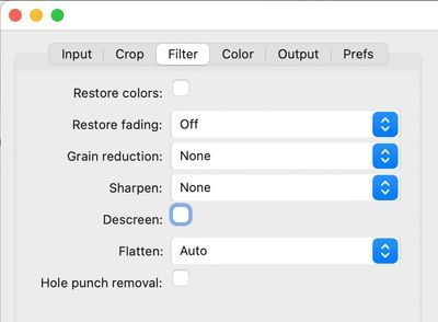

To expand on what James Gifford said, look in the scanning software to see if it has an option labeled something like “Halftone removal” or “Descreen”. The image below is what it looks like in the scanning software I use:
Basically, the print of the image has no actual gray shades because it was printed with fully black ink, so the only way to simulate gray shades was to render it with a halftone screen applied, which is a pattern of larger and smaller black dots. It’s that pattern that interferes with the pixel grid of a digital image and causes the moiré pattern.
This is a very common problem when scanning old images printed on a press, so if you do web research using terms like “descreen halftone scan” you’ll find a long list of techniques and plug-ins; some work better than others and it isn’t always possible to remove it completely. Whatever is used must match as closely as possible the frequency, angle, and dot shape of the halftone screen that was applied to the image when it was prepared for the press, and then undo that back into gray shades.
