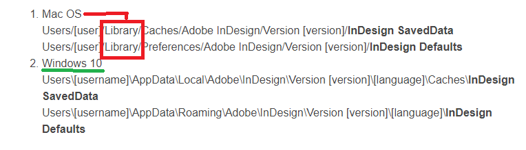

I found that I can't find the Library folder under my user name folder (I've also checked for hidden files/folders).
The Library is part of the path in the macOS instructions, not the Windows instructions:
