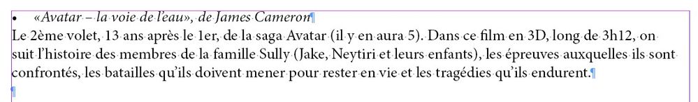

I have created some bullets in this screenshot.
For each paragraph, about the lines after the bullet point, I would like to move these lines to the left, at the green line on the screenshot. How to do this ?

Set the left indent on the style to 0

In each bullet , my goal in each parapgraph is to keep the first line unchanged, and move the other lines to the left (see green arrow in the screenshot).
So I put my cursor on line 2 and tried to change the left indent, but indesign show me an error window with : "incorrect indent value. The indents cannot go beyond the text frame" (see screenshot).

Set the first line indent back to zero as well.

La meilleure méthode, selon moi, serait d'avoir – pour chaque film – 2 paragraphes et pas un seul avec un retour forcé : le premier paragraphe (titre + réalisateur) avec une puce et le paragraphe suivant (description) sans retrait, tout simplement. Et si tu fais des styles de paragraphe, (ce qui serait le mieux), il suffit de définir des styles suivants : le style « titre » est suivi du style « description » et le style « description » est lui-même suivi du style « titre ».

I have done 2 paragraphs : a paragraph for the title of the film (in talic with a bullet), and another paragraph for the description of the film (that is as I expected : completely at left) :
But now, at the green arrow in the screenshot, it is different :
- I don't want to separate the first line and the second line (one single paragraph).
- I would like that the phrase beginning at the first line could continue on the second line, but completely at left on the second line.

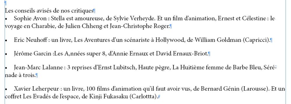

1) About the text of the page bottom :
I have set a paragraph style with :
- the bullet setting you see below.
- a space between paragraph
Here is the result after applying this paragraph style (the second line after the bullet is completely at left) :
2) About the text of the beginning of the page :
I have used another paragraph style (on the paragraph title only) with :
- the same bullet setting as before.
- italic style
Here is the result (the second line after the bullet is completely at left) :
Votes

My last response was what I succeeded to do (with success : it corresponds exactly to what I needed).
I had shared only the steps I have done in order to do what I expected.
