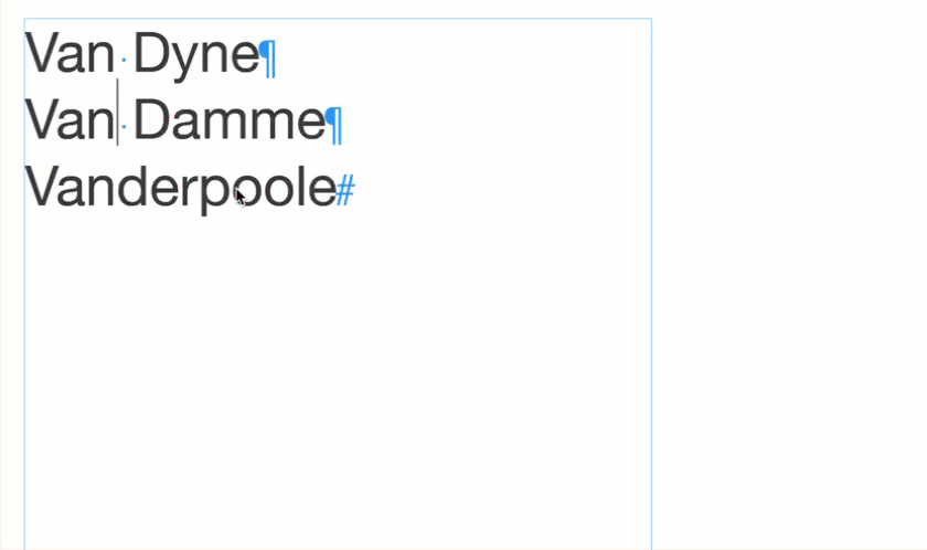

Hi Andrew:
Details help us help you faster. Are you using the script that comes with InDesign? If yes, did you try disabling Ignore Spaces?

Thank you. This is very clear.
Jan 24, 2025 Jan 24, 2025
Well, wait. These are two different features. Are you indexing, or sorting lists? If indexing, you want to fix the topic reference, otherwise you will have to fix the index after each update.
