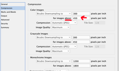

Community Expert , Mar 30, 2024 Mar 30, 2024
Since the effective resolution of your graphic was above 450, it is being downsampled to 300 according to your PDF Export Compressions settings. The result will still be good enough for print, but yes, will suffer on display if you zoom in.
If you want to avoid the issue, turn OFF downsampling or increase the threshold to, say, 600.

Hi @allisonh37240426 , I think Brad @ Roaring Mouse and @Scott Falkner  are right, if the placed file’s Effective Resolution is significantly higher than the Compression>for Images above setting (450ppi), the downsample would lower the export resolution. Here the Actual PPI is 300 and the Effective PPI is at your reported 1541:
The exported PDF at the same zoom magnification:
The same export, but with the Export>Compression>Do Not Downsample:

Thank you! I tried this out, and this was the issue. I appreciate everyone's feedback here and in determining what was going on. I figured it had to be something I was missing, but didn't think about my image being too large and sampling down!
