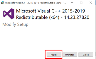

Adobe Employee , May 20, 2020 May 20, 2020
Hi all,
Please try the steps below:
  • Close all the Applications.
  • Go to Control Panel\Programs\Programs and Features.
  • Right click Microsoft Visual C++ 2015-2019 (x64)/ 2017-2019 (x64).
  • Click Change > Repair.
  • Restart the system.
  • Relaunch InDesign and check how it works.
 Let us know if that helps!
 Sheena

Adobe Employee ,
Hi all,
 Sheena
New Here ,
Hi Sheena,
This worked for me. InDesign and the other applications launch without a problem now.
Thank you so much!
