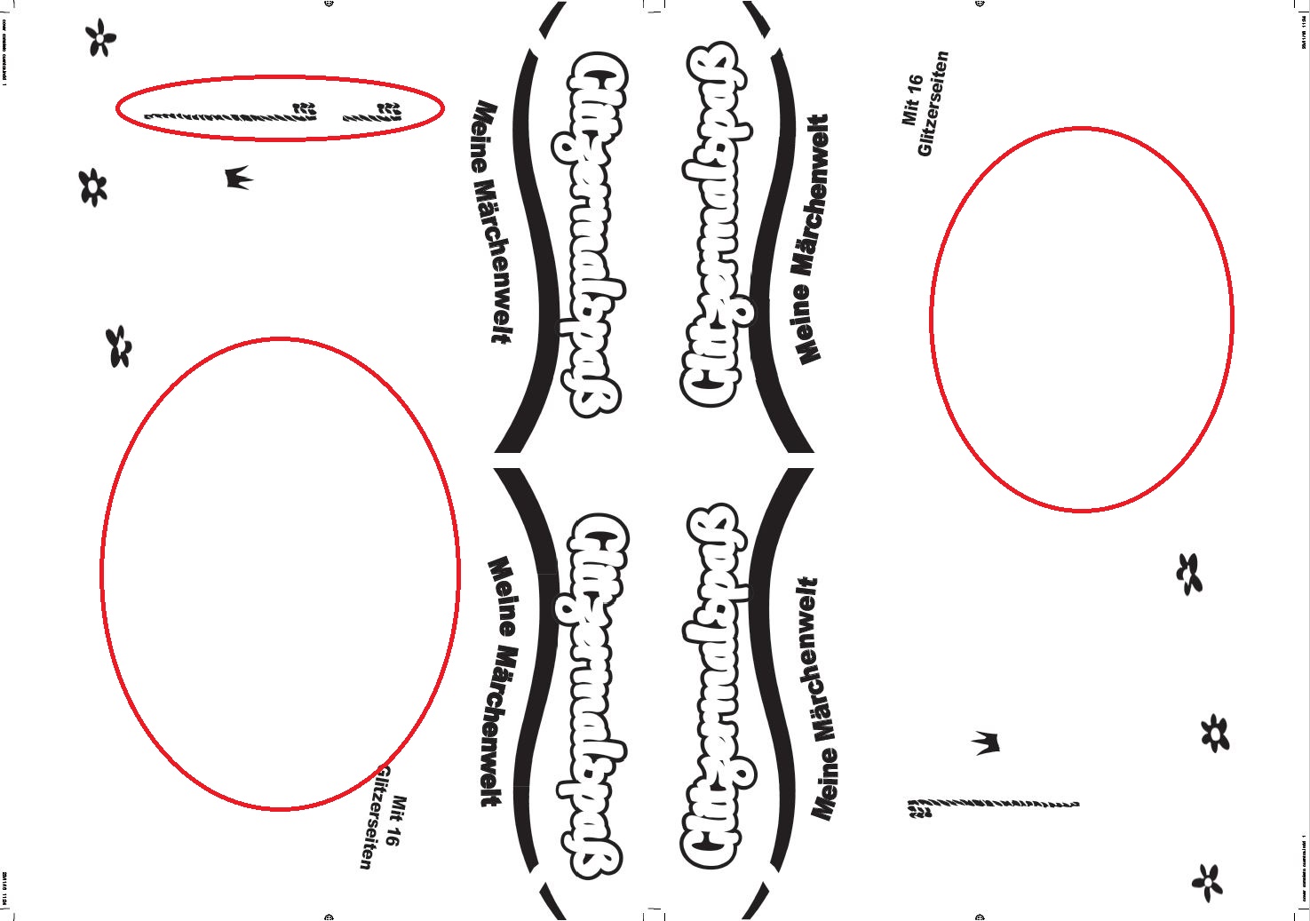

We had a few files which we saved with indesign in one file (we combinated few files in one) and after it, we exported them to PDF X1 - after export we had problem with one file - there was missing some elements.
After it, we tried to made an experement - Original file with whom we had problem, we opened it in Acrobat and save as PDF X1 - and there was not any problem, all elements was in file.
Please see files in link: https://we.tl/STfuK0zaD6
Can you please explain us where is the problem?

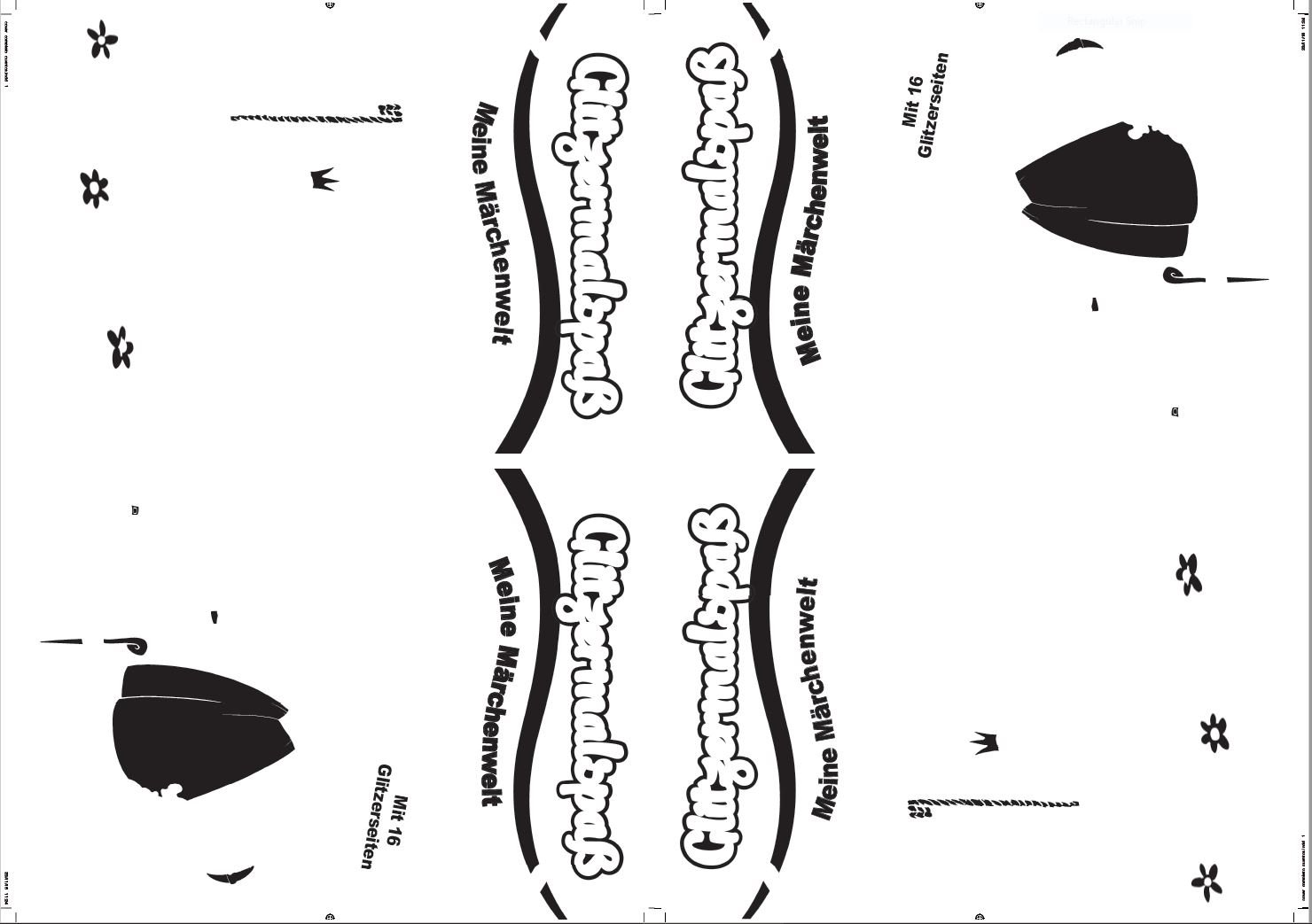

I was able to replicate your problem on Win7 / CS6.
Two possible solutions: either use PDF/X-4:2010 standard on export from ID, or flatten your placed Original.pdf in Acrobat prior to exporting it from ID.
Well, I know, you’ve tried it already and know it works. It’s not an answer to the question WHY.
Seems like InDesign may or may not have some problems to flatten it on export. FWIW, I had some bad experience with PDF/X-1a:2001 standard from ID, too.

just tested your sample document with CS6 8.1.0 on Mac OS X.
No problem to export to PDF/X-4.
No problem to print to PostScript and distill that to PDF/X-1a.
No problem to export to PDF/X-1a.
However, it took a very long time to export to PDF/X-1a compared with printing to PostScript or exporting to PDF/X-4.
Did not test with InDesign CC 2017.1 yet, the version you created the document.
I have no idea what's going wrong on your side with the bitmap 1bit images in the placed PDF.
Nothing's unusual. Just a PDF placed and rotated by 90°…
Uwe
