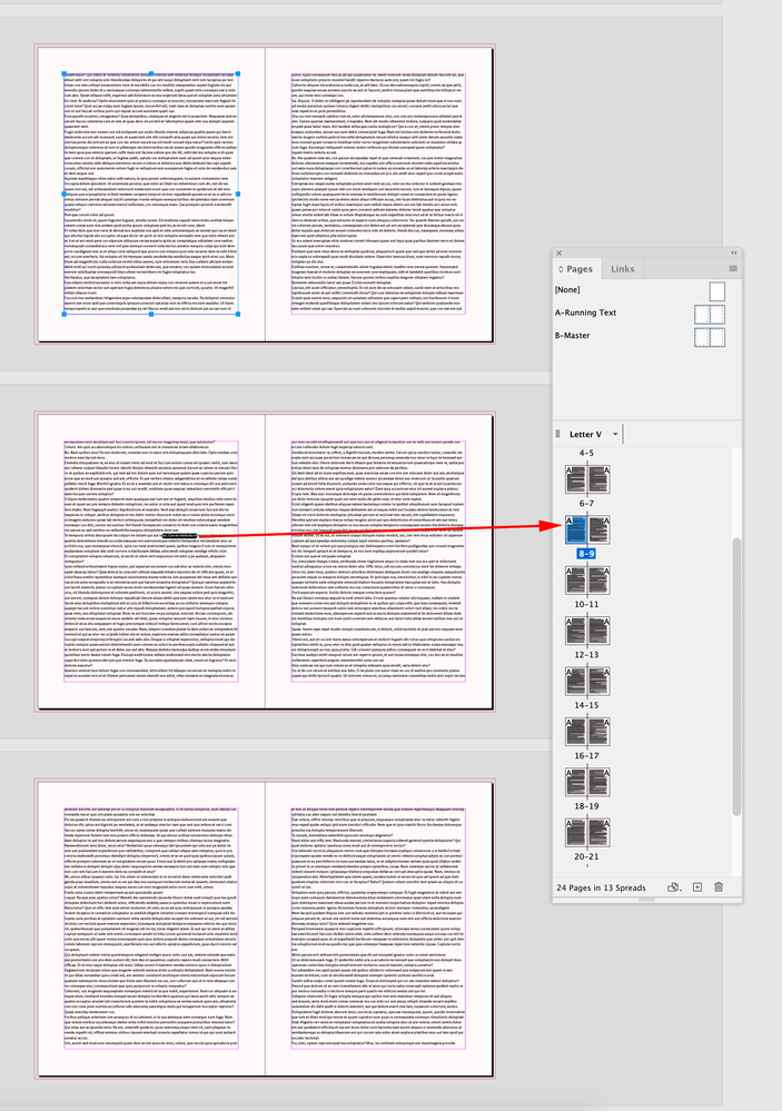

I wonder how much time this bug has wasted.
I noticed that when changing section-specific info in the Layout / Number & Section Options menu, sometimes it would produce totally unexpected results and screw up multiple sections and page layout.
It turns out that this is because pages are inexplicably selected in the Pages tab, unrelated to where the insertion point resides. Sometimes two pages are selected at once in that pane, other times only one... but frequently the selected one(s) is wrong. I didn't select it, and it doesn't reflect the page on which I'm working.
Further experimentation shows that it usually selects both pages of a spread, instead of the one you put the insertion point on. That is a major PITA; if you click on the right page thinking you're going to start a new section, InDesign will instead start the section with the left page, messing things up.
With the insertion point sitting in text, I expect any changes made to the section or chapter options to affect the section in which I'm working; not in some arbitrarily (and automatically) highlighted thumbnail in a disconnected pane.

And I've just checked - to be 101% sure - you can edit your text - DOUBLE CLICK on some page in the Pages panel - then start typing or just hit arrows - and InDesign will get back to your text.
And will even re-select the page where you're editing your text.
LEGEND ,
May 21, 2025 May 21, 2025
@Thomas_Calvin
Even more:
1) I was typing in a TextFrame - on page "1",
2) I've double clicked on page "3" in the Pages panel - to "activate" it - InDesign moved me there and showed me this page as "active" / selected,
3) I've used hamburger menu to start Section,
4) I hit arrows - InDesign got me back to the the text like I've never stopped editing.

Hi @Thomas_Calvin , You could script the Page panel selection to match the text selection’s parent page:
try {
var sp = app.documents[0].selection[0].insertionPoints[0].parentTextFrames[0].parentPage;
app.activeWindow.activePage = sp
}catch(e) {}
A random selection of pages in the Pages panel
After run
