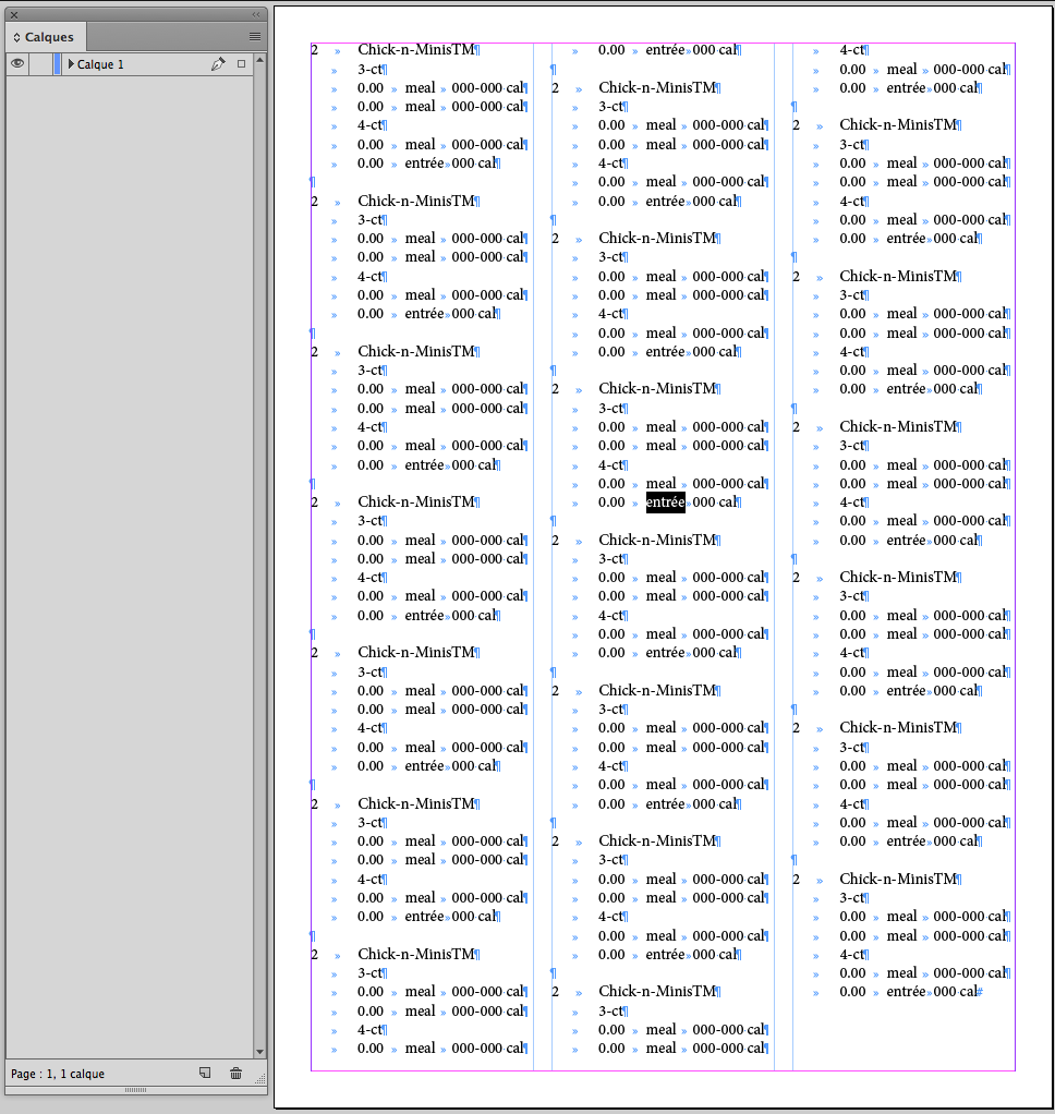

Maybe you don't see the question as me! …
… and, as Einstein, I think Time is relative!
Note: I've defined the layers numbering appearance!
The "Cut" script is based on a very simple grep code: [^\t\r]+
So, the numbering acts as if you play the regex and count, one per one, the items found!

LEGEND ,
Feb 28, 2017 Feb 28, 2017
"all the formatting and position of the text is gone and moved."
Explorer ,
Glad you think something's funny.
LEGEND ,
What I find funny is that you're totally wrong!
If you see (better) my screenshots, the first one is my layout before the script, the third, after! Exactly the same appearance!
The difference is that, now, we have a 320-pieces-puzzle ! one piece per layer without personalized name in the right order!
So, Yeap! it's funny you didn't see it!
