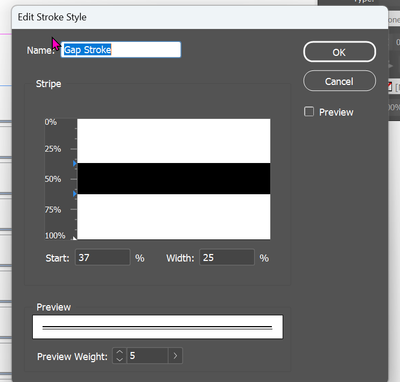

Another option is to create a custom stroke style in the Strokes panel wtih gaps at the top and bottom.
Then create a cell style (auto-applied to first column in table style) with the orange rule.
Note: I did not try to replicate your layout exactly.

I'm so close to getting this but I'm just not getting the gaps in still, I just can't for the life of me figure this out!! I don't suppose you could have a look at this .indd file and see where i've gone wrong?
Jun 16, 2025 Jun 16, 2025
Here you go.
(I don't know if this was just a quick sample, but you should learn to use styles to your advantage.)
