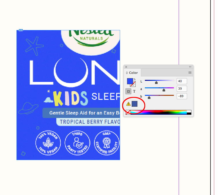

I have an InDesign file from the 2018 and it is a label I want to print. I just check that a few elements on this label are saved in LAB color pallets. So when I try to change them to CMYK they not as bright as my client would like to have. When I convert a whole document to CMYK it looks also different. It is any option to save it to print and keep bright LAB colors? Thanks for the help in advanced.

The blue in your sample is well outside of the typical CMYK color gamut, so it isn’t possible to match that color with process inks.
The Color panel displays a yellow warning triangle next to the closest printable color when a color is not inside of the document’s assigned CMYK space.

Thanks for the answer, so it is impossible to have the same color in CMYK pallet? So the solution is to make this label with CMYK color, will not be the same but printable? Is that correct?

The printer can print it with excellent colours, but the buckets of cyan, magenta, yellow and black ink that every printer uses cannot make bright colours like bright blue or green. This is a universal limitation, though the exact colours will depend on the kind of ink and paper used. If you want brighter colours, it is possible, using buckets of bright ink. These spot colours are not available in every workflow.

The only way you can print a color that is outside of the process CMYK gamut is by using a solid ink spot color on an offset press, but even with the Pantone solid ink system, the bright blue you are showing would be difficult to match.
Some composite Inkjet printers are capable of printing a wider gamut of colors, but I still don’t think you would get the full saturation of your Lab blue.
Also, most standard RGB monitors can’t display the full cyan/blue of a typical offset CMYK space, so the displayed blue is probably a bit more subdued than the color would print, but you would never get the full saturation of the color.

"Good colors" is a very relative thing. That little yellow triangle with the exclamation point in it is not.
When you see that "Out of Gamut" alert, it's not lying to you. InDesign is telling you, in no uncertain terms, that color cannot be printed with the CMYK process. If you can wave a printed card with that color under your printer's nose and say "This can be printed, see?" that's one thing. When you're asking him to hit a color from your computer screen that's outside of the range of colors that possibly can be printed, it's quite another. You're asking him to sweat milk for you. As the kids say today, that's un-possible.
The only way I could give you better news here would be to lie to you. And I can't do that. Your printer isn't lying to you either. I'd believe him.

The printer can only print blues that are in gamut. If they are a good printer, they have a good Colour Management workflow in place and should be able to get as close as they can get, but as Scotty would say, you can't change the laws of physics!
Your client will have to accept that they can't get what they want. Their best bet is to have the blue printed as a spot Pantone colour which may get you closer to what they desire, but that means you are paying for a 5-colour printing job. As far as getting brighter blues in CMYK, well, you can't. I suggest you invest in a Pantone swatch book that shows CMYK matches so your client can see what is and what is not possible.
Here's the deal. The conversion fron LAB to CMYK can be wildly different in practically every scenario, depending on the Color Management settings used along the way, as well as the actual printing process used by your printer, etc.  If it this was printed before from the same file, the CMYK mix that was previously printed WILL be different today if the profiles assigned to them then were different. It will be impossible to give your printer a new CMYK file with values that create that previous blue if you don't know what the values ended up being! It also depends on where the conversion happens. If you created a PDF that converts the colours at your end, then you've already baked in a CMYK mix for that blue based on the colour profiles you have in your OWN workflow. If the PDF was created where the colours are left as is, then the CMYK conversion will happen in your printer's workflow.
Going forward, you should always select colours that are in gamut of your intended printing process, or accept the fact that there will be differences. e.g. If you are working with Pantone colours (e.g. Spot Coated swatches, which are LAB), many of these are also out of gamut as they were always intended to be an actual ink used in printing (mixed using several base inks other than CMYK (there's about 15 of them) that create a wide vibrant set of colours).  Pantone has attempted many solutions over the years to help out the current digital workflows and the latest is a set of ink swatches called Color Bridge that are based in CMYK, so if you use those, you should be able to see and keep a consistent colour match.
