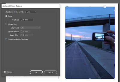

Not going full bleed, slightly smaller than margins, centered vertically and horizontally. Can't figure out where to anchor, as there is not text. Do I place a CR and anchor to that?
Steve
Sep 20, 2022 Sep 20, 2022
I did it in the first screen shot.
You just need a blank return.
Then anchor your text inline - see the screenshot
Margins
