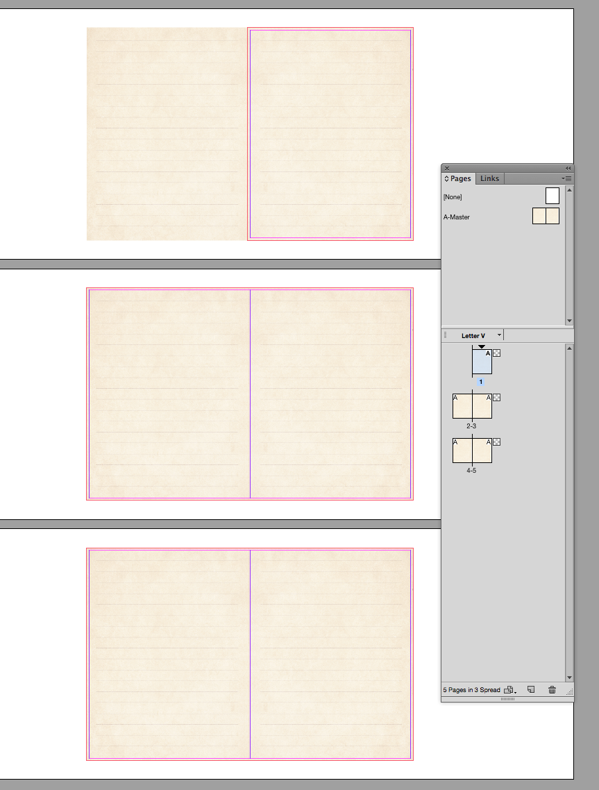

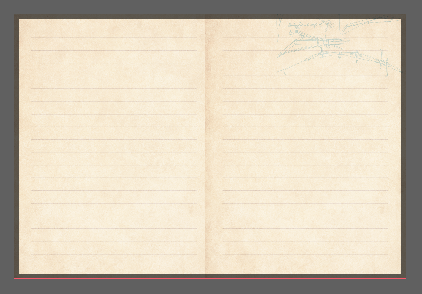

I'm having some difficulty exporting a spread without the bleed of one of the pages overlapping the other one.
So I have a background on every page to make the paper look like some sort of old scroll.
Every scroll paper has 3mm bleed on each side since it will be sometimes used on left side and sometimes on the right side.
But for some reason one page is always overlapping another (since InDesign puts spreads in the same layer structure instead of two separate ones). (fig 1)
I want to have a result like fig 2 when exporting as spread but still be able to export them as singles with bleed on each side without needing to manually crop every inside of every page...

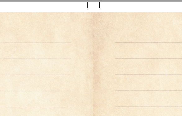

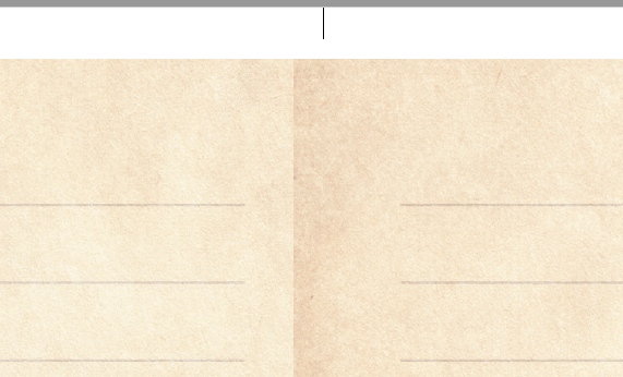

I tried making single pages and shuffling them back to a spread with a gap between them to zero-out the bleed (fig 3) but then I just get a spread with a double inside bleed. (fig 4)

The easiest way to handle background art like this is run a single image as a crossover:
A17x11 image across a letter master spread:
The pages:
Exported with all bleeds:
