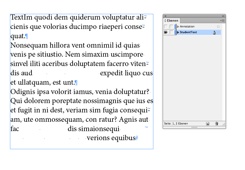

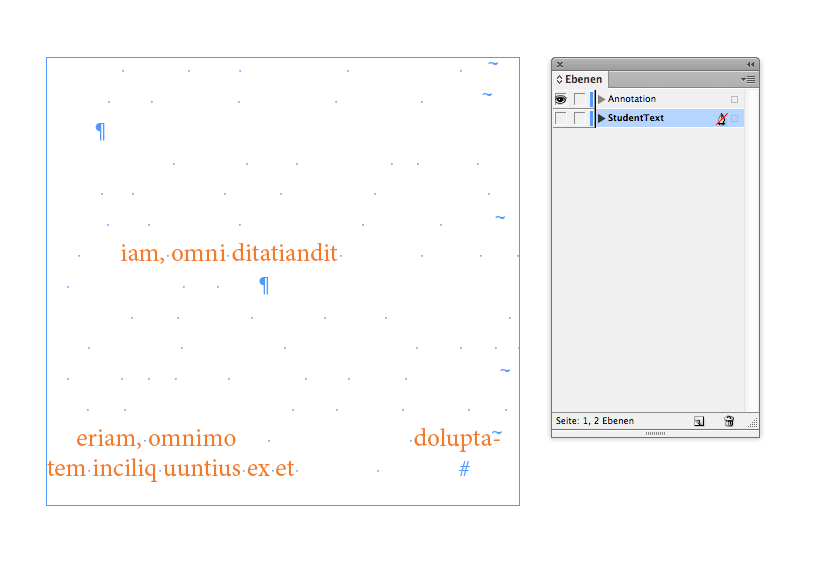

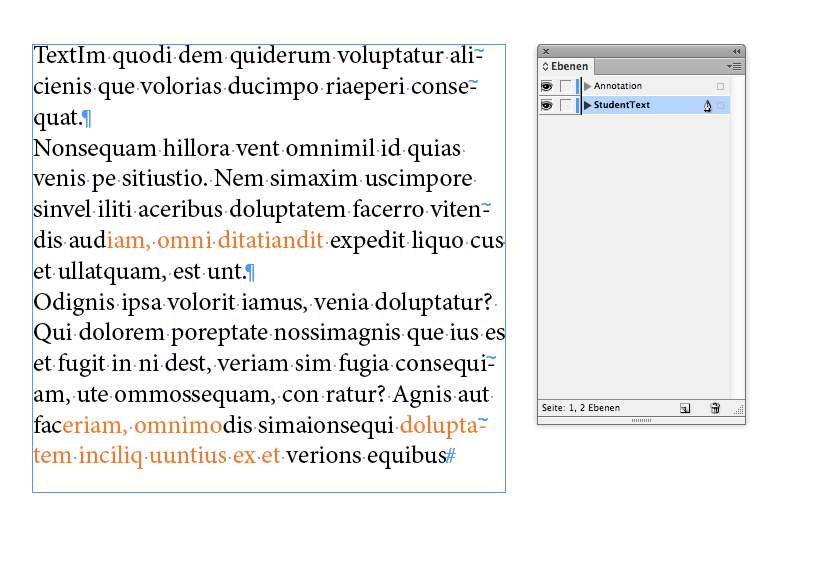

With InDesign:
1. An annotation layer could hold an exact duplicate of all text frames. Simply duplicate the layer that is already there.
2. The spotcolored text on the other layer could be filled with fill color "none". A search/replace action where only one layer is visible and search is restricted to visible layers.
3. The non-spotcolor text on the annotation layer could be filled with fill color "none". Also through one or more find/replace actions.
Both layers visible:
Annotation only:
Student text only:
Doable, but is this workflow reasonable?

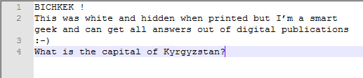

I realize now that I should have clarified what end result I'm looking for--something that vinny38 picked up on--which is a PDF of the SE file without the anno at all, for digital users. Changing the character color to the none swatch or white produces PDFs with invisible, but still accessible type. I'm hoping to somehow put the anno on a non-printing layer or have InDesign ignore a specific color when exporting PDFs so that I can, hopefully, easily produce digital versions of my student edition files.

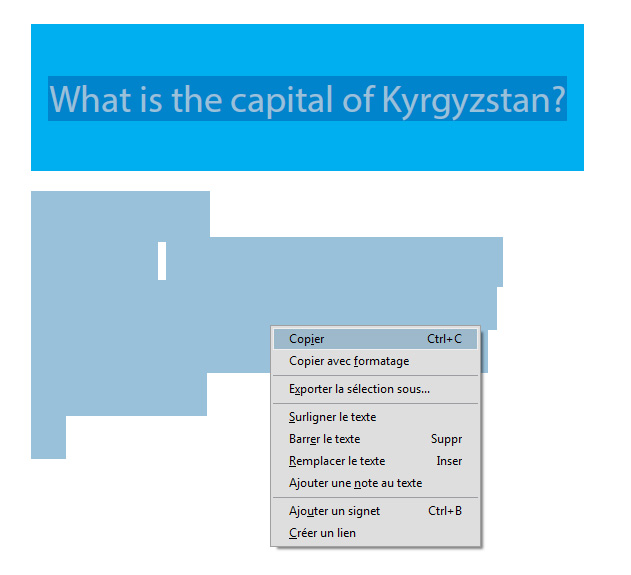

Personally I would stay with a PDF "postflight" solution with PitStop Pro if conditional text is not possible and PDF for online use should be published.
On the other hand, if InDesign's Publish Online feature will be used for publishing digital the two layer solution would be possible as well, because Publish Online is only using SVG shapes for text. There is no live text in the HTML you could copy/paste.
