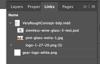

Interestingly, it looks like it does recognize and will package other kinds of links in the sub-indd file, including .psd, .jpg and .png. It just does not recognize .ai links for some reason, even in the main links panel. That seems more like a bug to me. I've filed one here:
Image of the sub-indd file's links panel:
Image of the main file's links panel:
