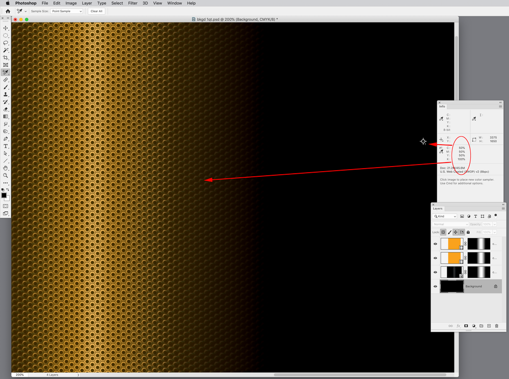

The layers above the black background are blending, so if you fill the background with a lower TAC it will affect the transitions and color appearance.Maybe no one would care, but try changing the black mix to something under 300% and you will see the change:
This is a classic example of why we shouldn’t edit in CMYK—it’s easy to violate the required TAC, and is the file really outputting to a US Web Coated SWOP press? The

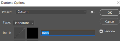

Is it a big deal to open in Photoshop and change it to the spot colour there?
https://planetphotoshop.com/working-with-spot-color-channels.html

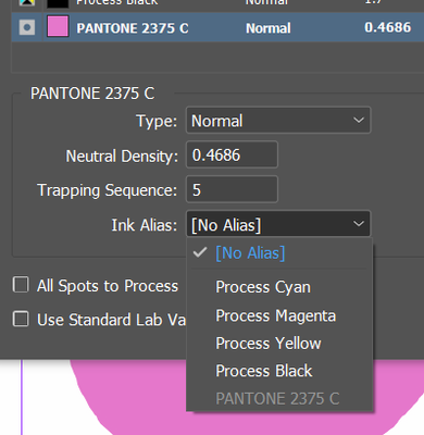

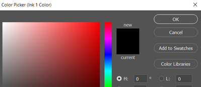

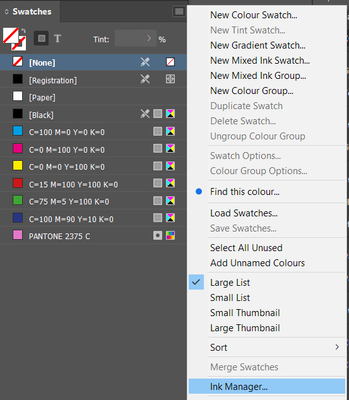

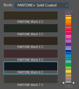

You don't need to make the background rich black in Photoshop.
Click the black square
Click Color Libraries
Select whichever colour you need
Import to InDEsign
Swatches panel
Ink Manager
Then pick your Ink Alias

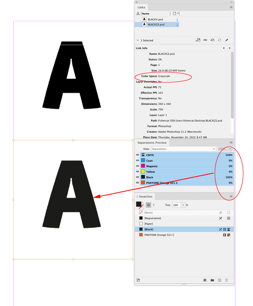

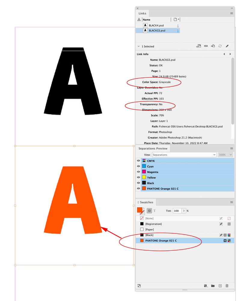

Hi @cbishop01 , If you open the PSD and save it as a flattened Grayscale the black pixels in the grayscale will output to the CMYK black channel. If you then Direct Select the grayscale image, you can apply any spot or process color:

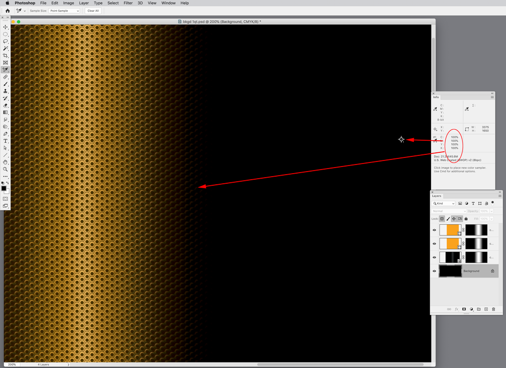

Nov 10, 2022 Nov 10, 2022

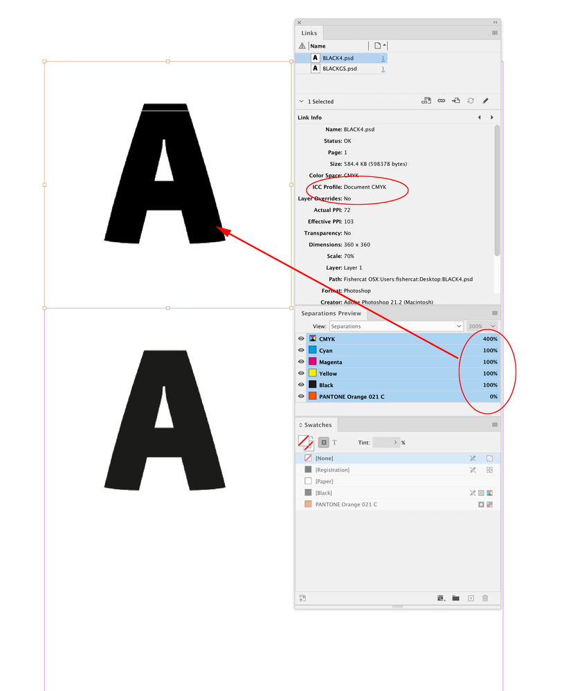

This is the org art. all the black you see is 100%CMYKThis is the org art. all the black you see is 100%CMYK

Hi @cbishop01 , The black background in your layered CMYK PSD is set to 100|100|100|100. Do you really want to print a Spot color—a separate separation plate with a custom ink on an offset press, or are you printing process CMYK and want to fix the 400% total ink problem?
Advisor ,
Nov 11, 2022 Nov 11, 2022
Yes i'm just wanting to fix the problem. i was thinking if i convert the color to Spot i can have my rip convert it to any shade i would like. but Total ink is what i'm trying to fix

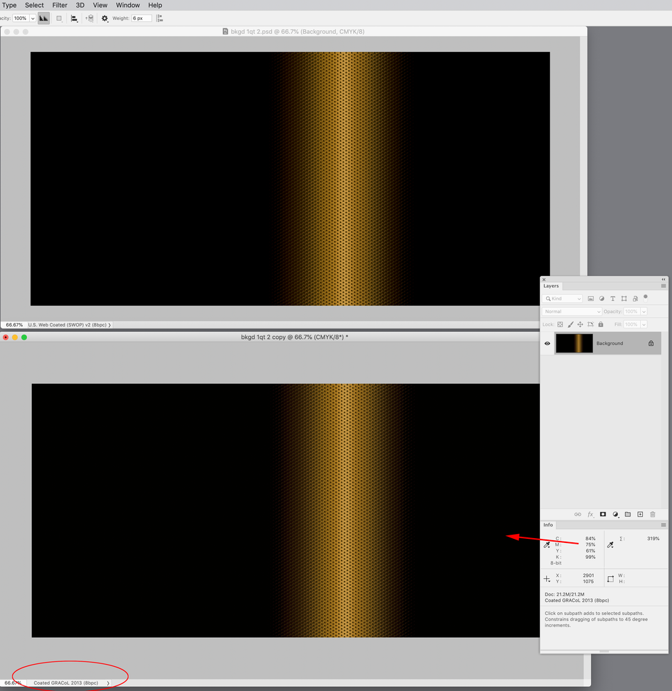

Also, if the issue is the 400% total ink, you can convert to RGB or Lab, then back to CMYK, and the total ink will be limited by the CMYK profile you use for the conversion—US Web Coated SWOP has a maximum of 300%.

I don’t think there is a way to automate a fix that keeps the layers without altering the image appearance.
The problem is editing in CMYK mode, which doesn’t put any limits on total ink—the background layer is at 400%. Ideally the art should have been created in RGB mode
You could flatten the images, convert to a large gamut RGB space (AdobeRGB, eciRGB), place the RGB files and let the CMYK conversion happen at export or output. In that case the total ink allowance would be limited by the destination CMYK space, which for most coated profiles is between 300% and 350%

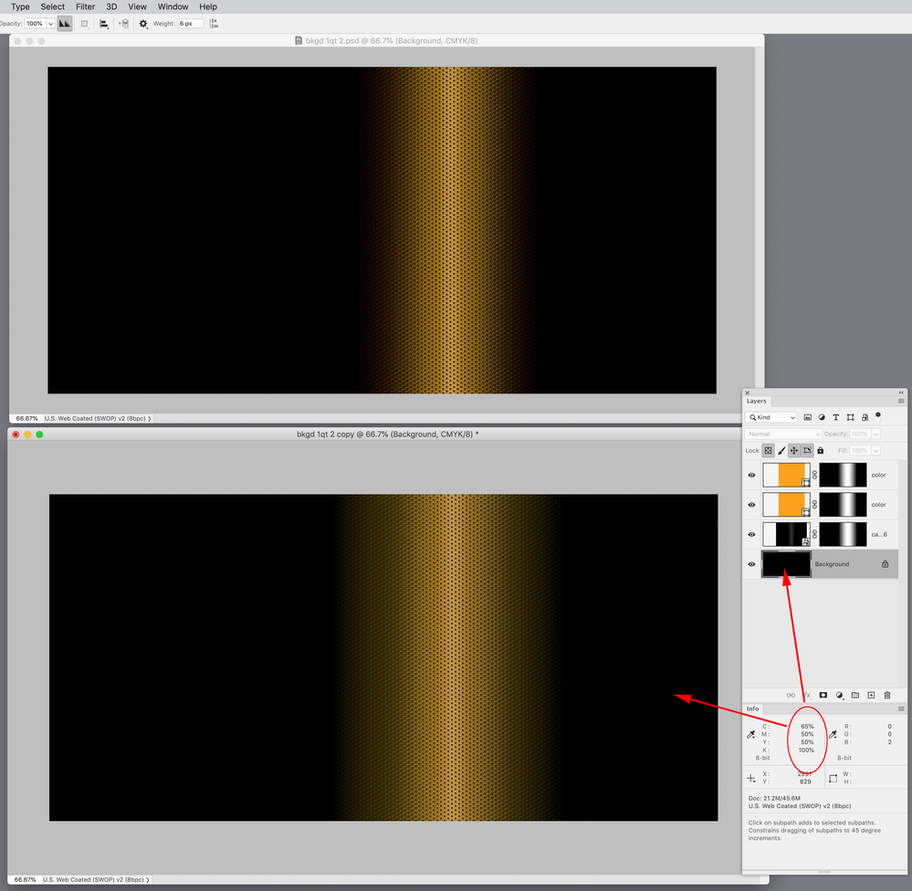

If you are trying to preserve the appearance, I don’t think there is an easy way to do it in CMYK mode. Here’s what I get if I replace the 400% background with a 265% rich black—the transition into the rich black is different:
Here’s flatten>convert to ProPhoto>convert to Coated GRACoL 2013:

Sorry @cbishop01 I'm not any help here. I cannot see any room for usefully scripting anything here because I can't see any one process that would solve this for multiple examples, unless they were each set up exactly the same.
The confounding factor is the use of "Hard Light" and "Overlay" transfer modes on the orange gradient layers in CMYK. In my opinion, this sort of job should be done in RGB (which plays well with transfer modes) and then flattened/exported to CMYK using a color profile that gives the appropriate total ink for the print method, or even manually using "Custom CMYK". But if the final background CMYK black would need to be consistent with other background blacks in the job, so you would need to take care of that.
- Mark
(Off topic: if I was setting up this artwork, I'd do it all in Illustrator, and make the honeycomb a pattern, and keep the document in RGB, and then export/rasterize to CMYK for the printing. Or even better, I'd re-jig the artwork so no transfer modes/transparency were needed and do the whole job in CMYK, with full control over the ink everywhere.)
