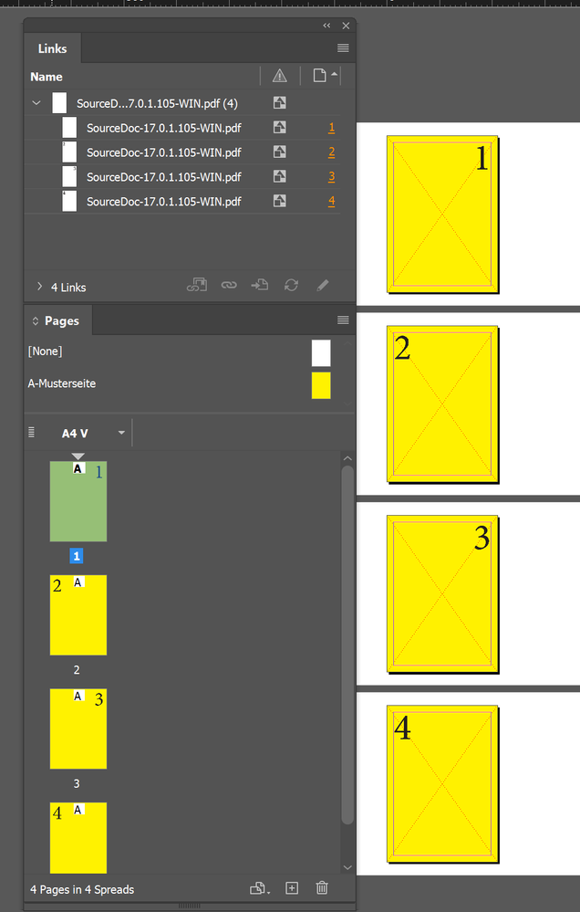

I solved this riddle with your DC.indd document and the paradox view of the embedded PDF pages.
If I turn on "Normal View" I see what you are seeing. Four different PDF pages placed and embedded:

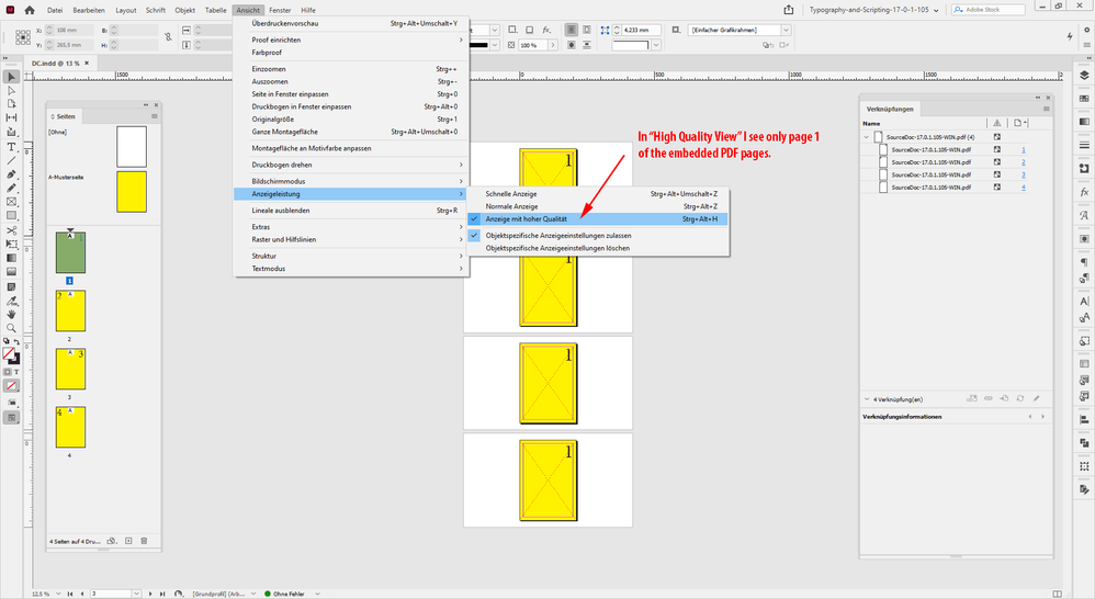

A switch to "High Quality View" reveals the bug.
Only the embedded PDF page 1 is there four times:

FWIW: Personally I never work in Normal View, always in High Quality View.
And I never embed any placed graphics or images.
And as we can see in the sample above: Never trust the Normal View.
Even more: Always work in High Quality View and turn on Overprint Preview as well now and then.
