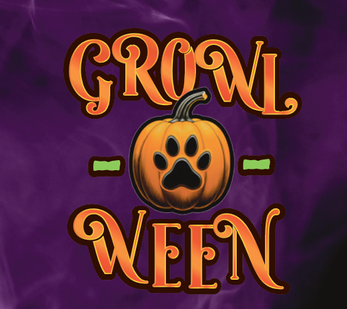

I've come across a specific issue with a placed image in InDesign and I'm wondering if there are any export setings that would fix this issue? An image of the issue is attached—the whole document is in CMYK and this placed picture is a PDF. The white box showing up in the middle of this logo only shows up in InDesign, I've opened the file in Illustrator and it seems to be perfectly fine there.
I've also checked the Overprint Preview, and the box does disappear with that preview on, but still prints with the white box. I'd love to try any PDF/InDesign settings to see if they help. Thank you!

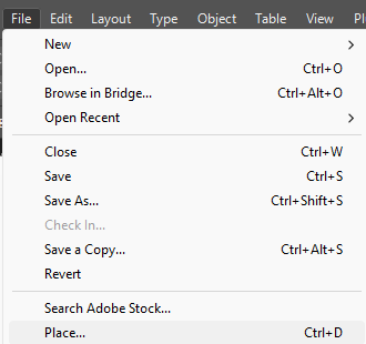

you can also "Place" a pdf
and then check 'Show import options'
and check tranparent background (the file has to have a transparent background)

Thank you for this! I went through these steps on a new InDesign file and the white box has disappeared. So I went back to the original file I was trying to place this PDF in and for some reason the white box still shows up when it's placed. I'm racking my brain on what setting would cause that box to appear in one InDesign file but not another. Their color profiles are the same, both CMYK.
^How is appears when successfully posted in the other document. I'm glad it's seeming like all I need to do is tweak a setting in the file, I was worried the issue was going to be more complex.
