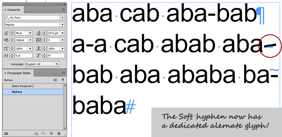

What does it? It specifically assigns the Alt-Swash character style to the SOFT HYPHEN ("Discretionary Hyphen" in InDesign). Since the glyph actually used for the soft hyphen is the /hyphen glyph, a great thing happens: our custom swash variant /hyphen.swsh will be used as well through the GREP style assignment 🙂
Finally, we just have found a solution to get a custom soft hyphen in InDesign:

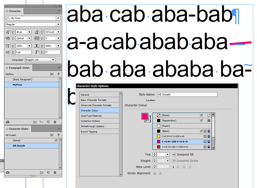

What to conclude from your test? I'm lost. Maybe those special characters, while available to GREP style captures, are set to automatically discard or bypass character attributes considered irrelevant in default rendering context (?)
However, I tested your idea on my previous example, changing the horizontal scale and even the color of the Alt-Swash style. And it worked fine as shown below,
