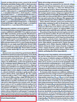

Can anyone explain why subtraction value is different?
Expected output : 12
Result output: 11.9999999999998
baseline
Result: 732
textColumn.endBaseline
Result: 720
baseline - textColumn.endBaseline
Result: 11.9999999999998

Thank you for the response. Below you can see data browser and available space in page.
Under the last line exactly 12pt space is available.
Here you can see data browser shows:
baseline: 732
endBaseline: 720
diff: 11.9999999999998
