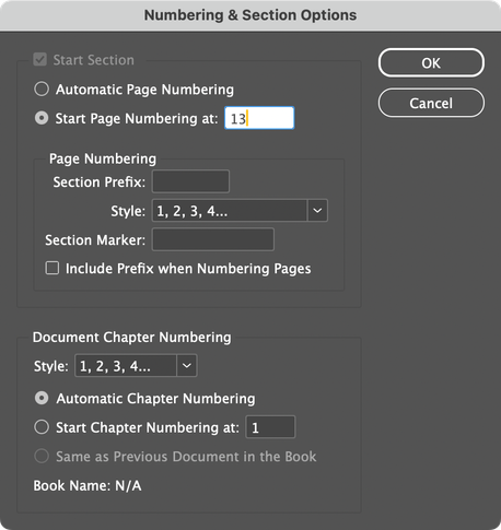

If you want each chapter to start on an odd numbered (right hand) page then first create a new section starting with the first page in each chapter and set the page number there before moving the pages to Document A.
In the Pages panel select the first page of the chapter then go to the flyout menu and select Numbering & Section Options…

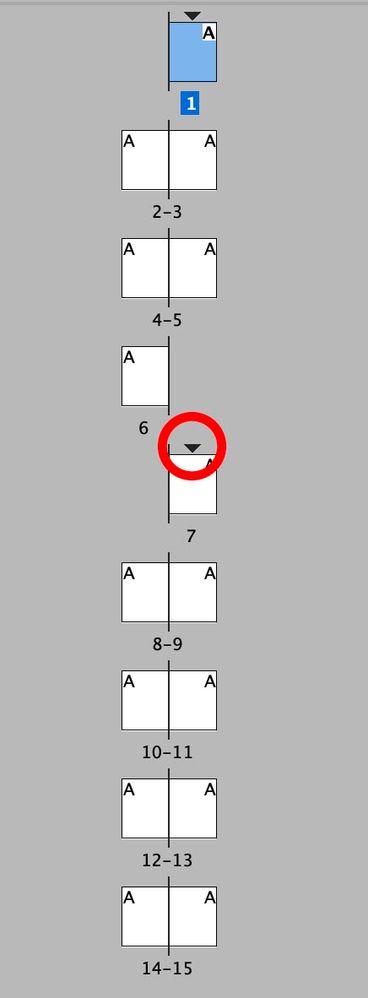

Jun 02, 2024 Jun 02, 2024
If your pages look like the first illustration below, the second section of pages may have a Start Section icon turned on (circled in red)::
Double-click the down-poining arrow icon to open the Numbering and Sections dialog (shown below)
UNCHECK the check mark at Start Section, and it should be corrected:
