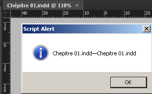

I agree with Luca Bisin. I saved a document as "Chépitre 01.indd" and ran your script. This was the result:
What version of InDesign do you have? This was CC 2015.2 (latest CC version).
