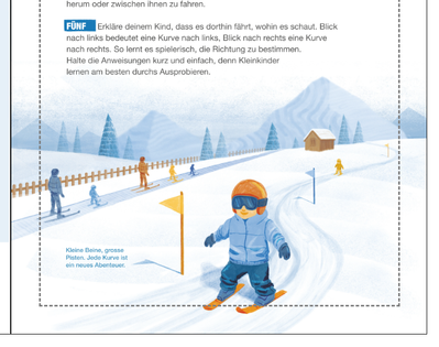

Hi, i'm struggling to publish my book on KDP. Somehow it tells me that there is text outside the margin. but there is only an image. I have a book with Bleed, the KDP support already confirmed that the pagesize trim, bleed everthing is correct. I even created a copy of the page and deleted just the image, that is accepted by the kdp previewer. Did anyone have something similar or has an idea how to solve this?

Looks like the ski is outside the page area and in the safety zone.
Images have to reach the bleed area. And the ski doesn't.
I'd say that's it.

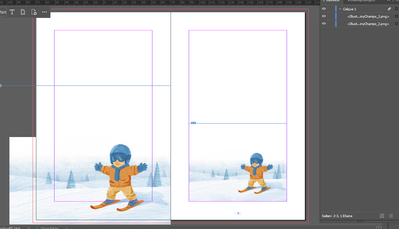

just tried to move the image up. it doesnt change anything. also as reference the same page without the image. Also it works on some of the other images, which is very strange

it is very weird that it looks like the red zone stops 1-2 pixel before the end of the page. but on the uploaded pdf it is definately all the way.

newest try. Absolutely nothing on the page except for the image. If the image goes accross the page it doesnt work, if it is inside the bounds it does. But i have bleeds enabled?! how is thi spossible?
Oct 28, 2025 Oct 28, 2025
That page number marker has been hidden behind the image in previous screen shots and I didn't notice it before. What happens if you remove it from the page?

Hi Peter, this was the issue! Somehow the page numbers were a few pixels to low, the previewer didnt show me this as error on pages without image, but it flagged it on some of them with images. This was one kind of a journey. Thanks everyone for taking the time to help.
