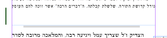

So maybe you have an idea why i have these gigantic gaps bewtween the end of the text area nad the beginning of the footnote area? I have tried adjusting the FN layout setings and have not accomplished really anything. Extremely frustrating....

Show us an example what you see, then we can help further.

Don't let it distract you that it is in Hebrew. The line at the left is showing the enlarged space:
too much space before fntoo much space before fn
What also doesn's make sence to me, is that on the next page there is on line of this paragraph, an orphan. But there is plenty of space to put here before the FN area. If i set the setting to 2 lines in keep it pulls an addiotional line form this page and puts i on the next! Why can't it fetch that next line on the next page and put it here?!

I don't see the whole page and neither the next page.
If in the coming line is another footnote which has not  enough space on the first page, then a  page break is inserted, even if it looks there is enoug space on the same page.
