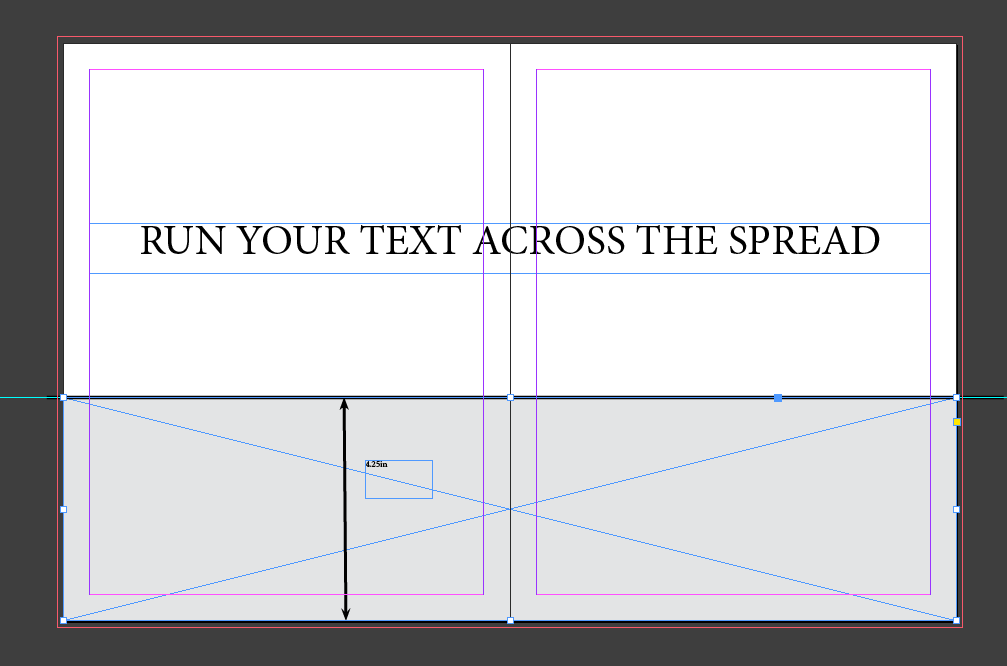

if you are doing the layout in spreads. run you text across the way you want. Measure from the edge of the paper into the page your 4.25, your fold, place a guide, and that is your fold. like attached.
does this answer your question?

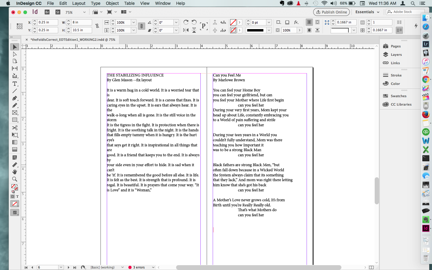

Thus, I would like the text to be printed on two pages and joined via a physical fold of the paper. Right now when I print, letters are lost at the gutter as words run across the center line. I would like to create a gutter for this story alone as other pages have different formatting. The below is a two column formatting for two poems.

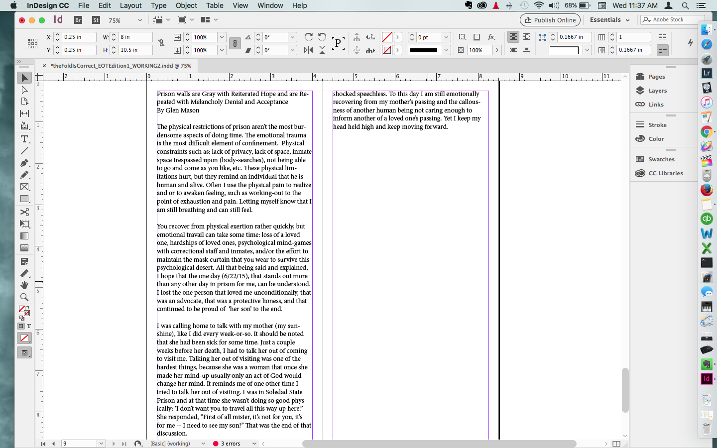

The below is also two column formatting with a single story that overflows into the next column. This is not the formatting I am seeking help on.
Again, when I would like to do is create a gutter for a single spread so the story (the first image) can read from left to right like a book without losing any words at the center.

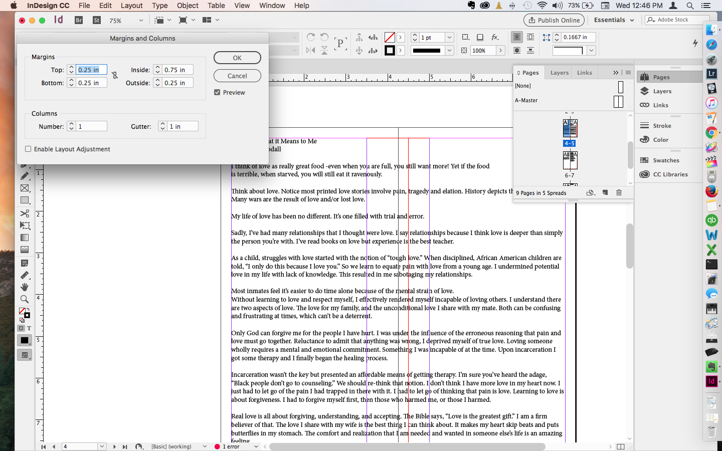

To adjust your gutter you need to adjust your margins, looks at my screenshots:
When you get to this image below. unlink so you don't adjust all 4 sides. you want to just adjust the inside one. Have both pages selected from your pages panel so you an adjust this ( and be on the master panel so you can make a master out of it for reuse).

Hi JonathanArias! Thank you!
Attached is a screenshot of the adjustment made. The interior purple lines show where I adjusted the margins to and the dialog box shows the change. Unfortunately, the text was not altered in any way and every word shown as falling on the center line was split between the two pages. See second attachment.
