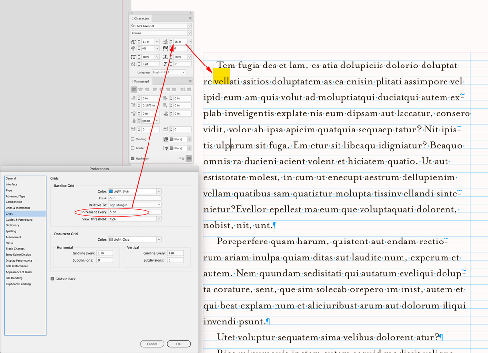

Hi @Summayah5FC7 , Looks like you have Align to Baseline Grid turned on, but your Leading and Space Before/After are not even multiples of the Baseline Grid? If that’s the case, this thread might help with unexpected baseline alignments:
https://community.adobe.com/t5/indesign-discussions/aligning-end-of-paragraphs-across-spreads/td-p/1...
Here my Baseline Gride is set to 8 pt and all of the text Leading (the distance between the texts’ baselines) is set to 16 pt:
Engaged ,
Nov 04, 2025 Nov 04, 2025
Yes i have set it to align to baseline grid, multiples of 7pt. All paragraphs have leading of 7.
If all the text is set to the same 7pt Leading then you don't need to turn on align to baseline grid. Can you share the document?
So why do you need the tiny paragraph? Removing solves the issue. Keeping it—even at 0.1 pt—forces the text the text below to the next baseline, because that's how snapping to the baseline grid works.
