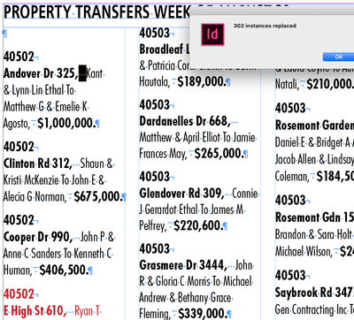

Thanks, Manan for the video and adding the alert. I watched the video and noticed that there were only three instances with double spaces, but if you add more spaces, eg 5+, and run the script again, you'll see what I'm trying to say.
In my example document, I had to run the script five times to see the message "0 instances replaced".

Ahh, this seems to be the situation that Peter mentioned, change the function call with what he sent, i.e. the complete script would be as follows
grepSearch("  +"," ");
function grepSearch(f,c){
    app.findGrepPreferences.findWhat=NothingEnum.NOTHING
    app.changeGrepPreferences.changeTo=NothingEnum.NOTHING
    app.findGrepPreferences.findWhat = f;
    app.changeGrepPreferences.changeTo = c;
    var a = app.activeDocument.changeGrep( true )
	alert(a.length + " instances replaced")
Try it and share the test results, if it still does not work then share a sample document with the issue.

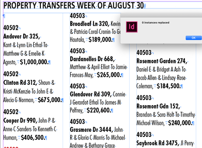

Masood,
What Peter implied is tha,t generally it should not be needed to repeat the grep as it can be handled in the grep expression itself, an example being the use of + in the double space case. Now if you absolutely want to loop then give the following a try
	do{
	}while(a.length != 0);
-Manan
Participant ,
Sep 03, 2020 Sep 03, 2020
Hi Manan, That's exactly, what I was looking for. MILLION thanks.
