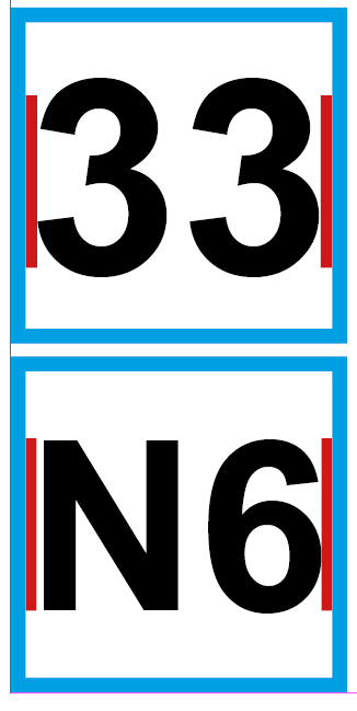

However, I'm still having the same problem when there's a letter involved (see example below, the 33 is fine, but the N6 text is slightly bearing to the right again as shown by the red lines).
May 03, 2022 May 03, 2022
You are dealing with how the font was designed; every letter is positioned on a matrix with a certain distance from the edges. So as you can see in my sample, the "N" has more space from the left edge of the matrix to the edge of the letterform than the "6" does from the right edge. This is up to the designer/foundry. Typographically, for optical balance, straight edges are designed with more space than rounded or "pointy" shapes.

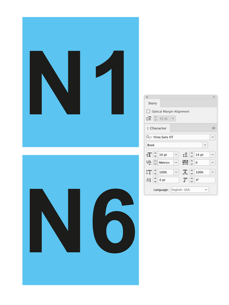

I was hoping there would be an auto- fix as I have several hundred of these to do!
You might want to experiment with the text frames‘ Optical Margin Alignment, which attempts to optically center the characters:
Turned off:

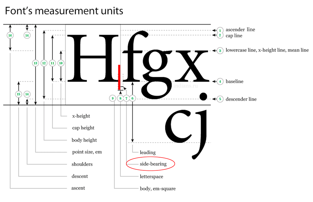

Hi @Nathan22148242akgt , Also, a font’s characters have side bearings, so the amount of side bearing space to the left of a capital N would vary from font to font.

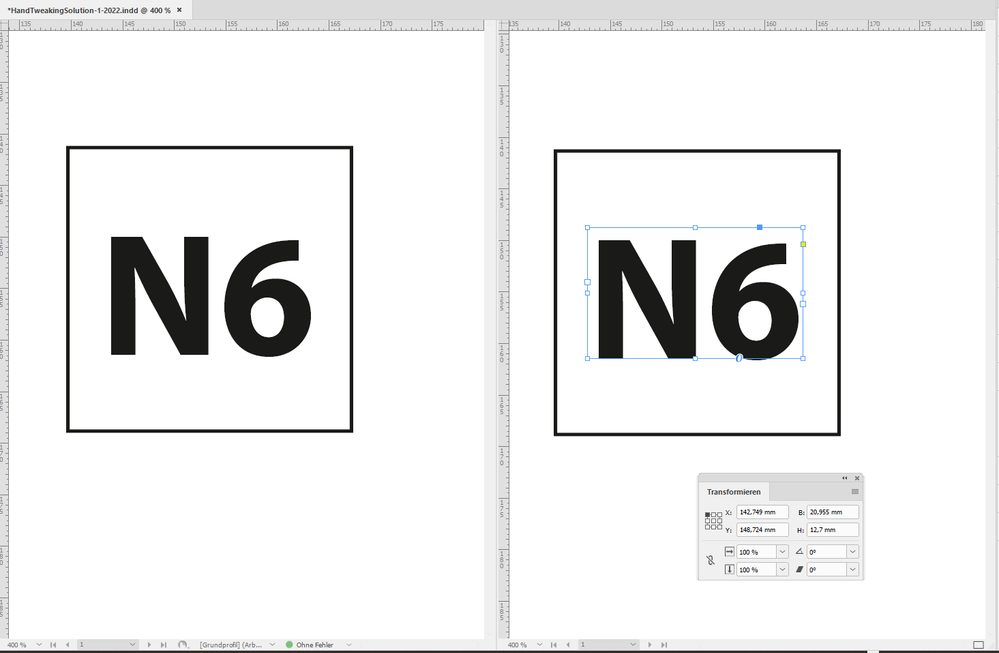

Hi Nathan,
something you could explore:
"Hand tweaking" the center position of the characters with e.g. setting the paragraph to right aligned and adding a small rectangle anchored behind the last character. Select the anchored frame and change its width with the Transform panel's input field for percentages for subtle movements using the keyboard arrow keys:
The selected anchored rectangle gives you nearly no distraction.
But if this still distracts you, open a new layout window for the same document and spread and change the view there. In one layout window you do the manipulation of the width, either using a rectangle like the one in my screenshot above or an insertion point for changing kerning values, the other layout window is showing the bare result without guides and stuff.
Uwe Laubender
( ACP )
Two layout windows where on the right the text frame is selected and moved.
On the left you see the immediate result without optical distraction:

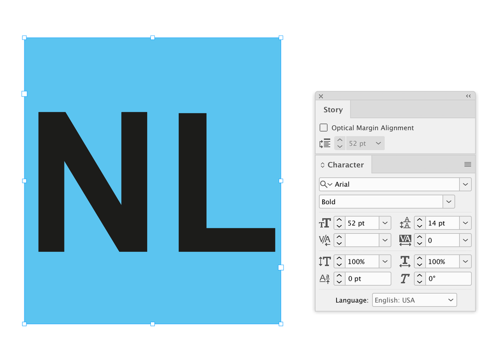

OMA is pretty good—but I wonder how Sensei would handle this:
