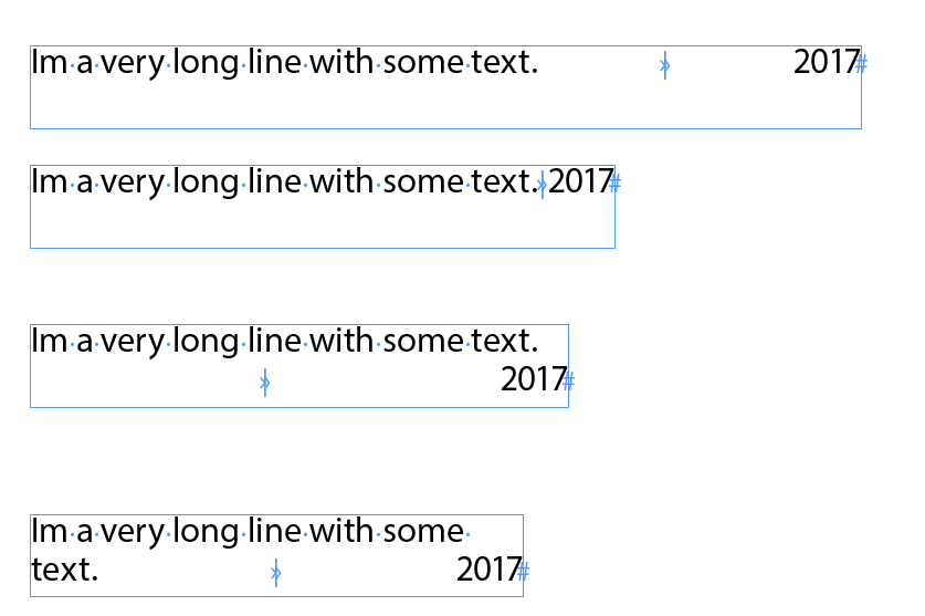

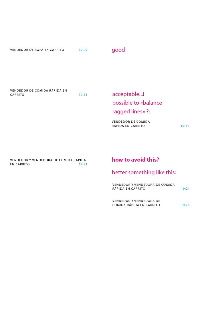

In this example it is necessary to avoid the collusion of text and number as seen in the third example/left column.
It is possible to manage this with some Indesign resources?

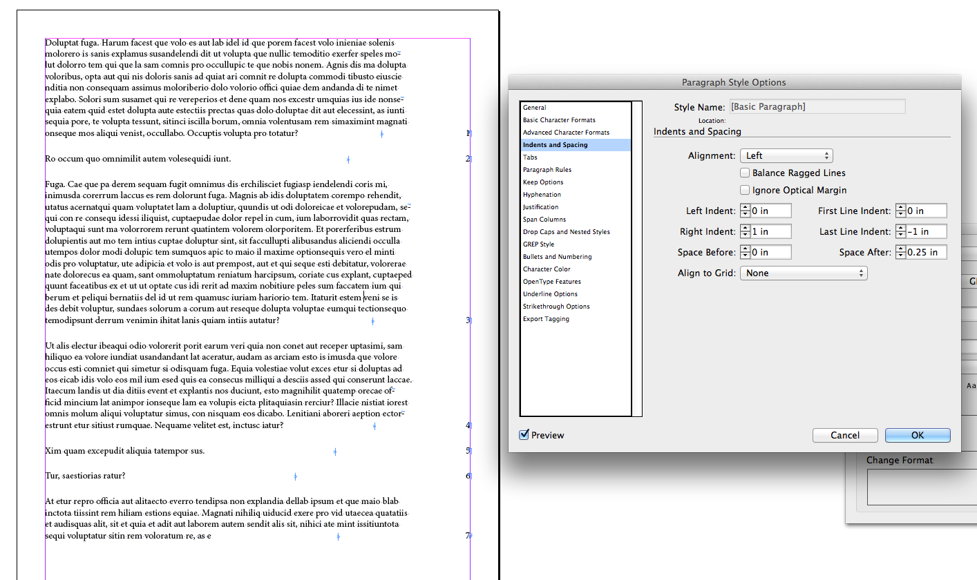

Guide , May 14, 2017 May 14, 2017
Try removing the soft returns (line breaks that are not paragraph returns) and set your right indent to the amount of space that will clear your page numbers. Then set the last-line indent to the negative value that you set for the right indent. For example, right indent at 1 inch and last-line indent at -1 inch.

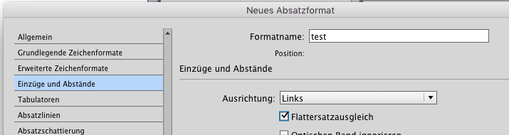

What about:

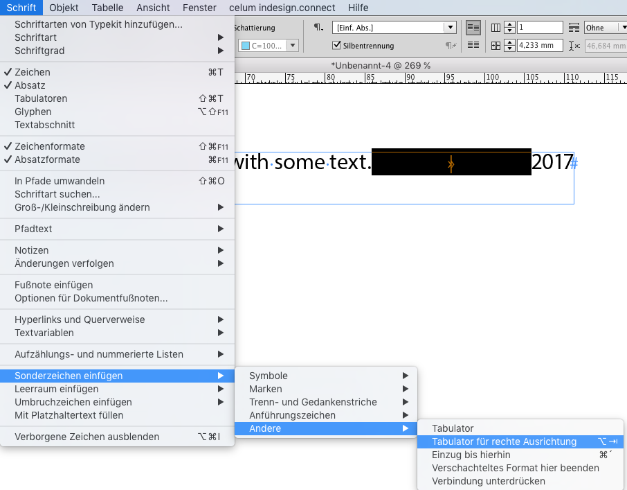

Or just with a right-alignment-Tab:
Participant ,
May 10, 2017 May 10, 2017
DBLjan,
Yes, it seems the resource inside ID to manage this!
In TOC is a very common nuissance.
Let me test it.
Thanks in advance,
c.

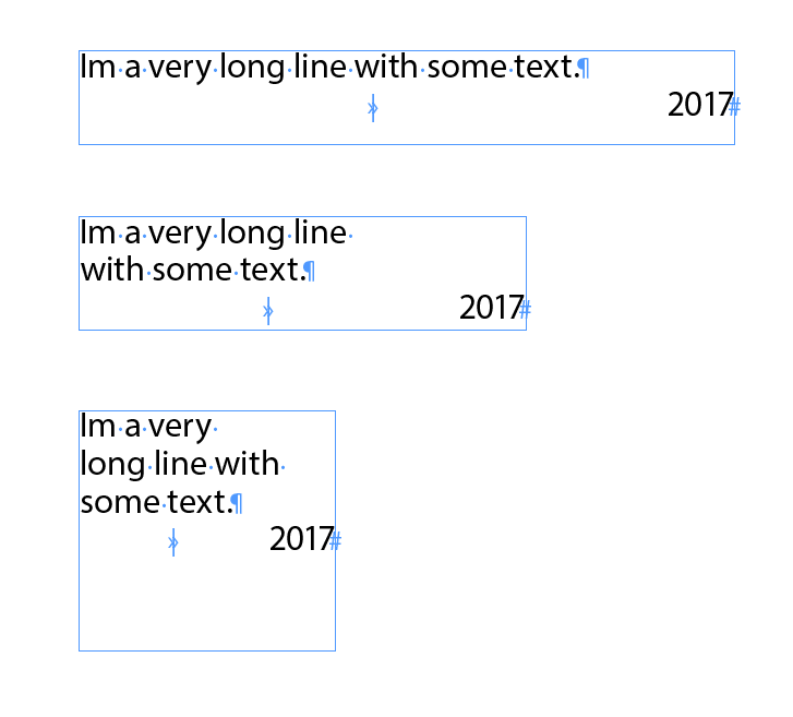

Hi, DBLjan,
Sorry for my delay.
Here is an example using right tabs.
In your example sometimes you added a new line to insert the page number... With that trick the folio gets converted to a new style and the problems is resolved, as you have two different styles to manage the text...
No, the page number must be in line with the last line of text.
Please, see the example. Perhaps I did not catch your idea: always the text penetrates the whole space to the right as in this example.
That is not fine.

Guide ,

Participant ,
May 16, 2017 May 16, 2017
Hi, Migintosh,
Finally got your solution. Thanks a lot for your time.
It seems so easy but I was looking for this a long time, specially for TOCs.
