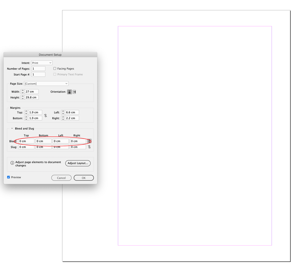

Oct 29, 2023 Oct 29, 2023
I have removed all bleeds, and it makes no difference.
How did you remove the Bleeds? From Document Setup or did you set them to 0 in the Print dialog?

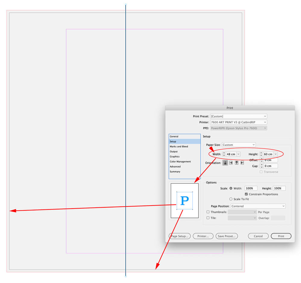

Also, you’ve set the Document size to the paper dimensions. The Document setup should be to the page’s trimmed size, and the Paper dimension is set in the print driver. Here the Document Page’s trim size is setup as your 29.8 x 27 with Crop Marks, and in the driver I set the Paper Size I’m are printing on—48cm x 60cm in this example :
Unless your printer is capable of printing edge to edge, the Paper Size has to be larger than the document trim plus any Marks and Bleeds
