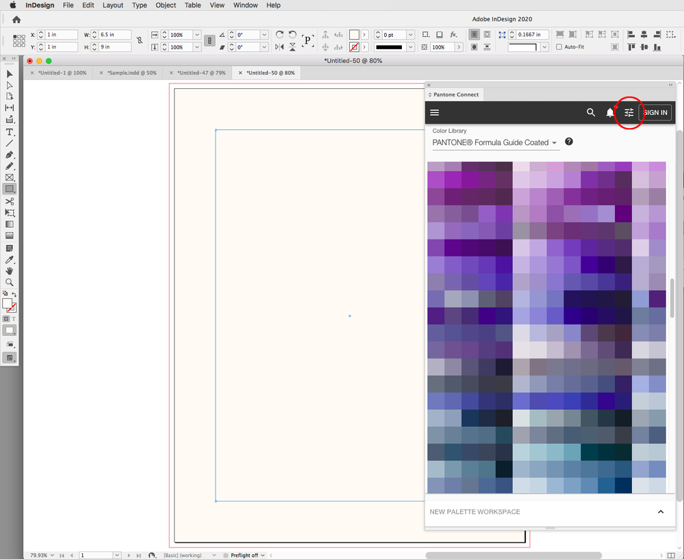

There is also the new Pantone Connect extension, which you can get from Adobe Exchange—from InDesign choose Window>Find Extensions on Exchange...
You don’t need a Pantone account to use it although you will be prompted to create an account.
From the panel you can load any of the libraries, use the Filter icon to filter for a specific number and add the swatch to your InDesign Swatches panel. The Solid + libraries are defined and saved as Lab colors—spot colors need the Lab definition to be displayed accurately. Here‘s the Connect panel showing the Pantone Solid Coated library:
Filtering for 2167
Adding the Lab swatch
